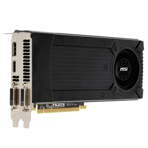

What has happened to my Graphics Card (GTX-670)

I tried figuring out what the Code 43 error in the device manager under display adapter is supposed to mean and how to fix it also using google but to no avail. Updated the driver software for the GTX 670 in the device manager, still the same issues.
Do you think a repair install would do, too? Don't really have the time to organize back up of personal data. Also, I figure that rma would easily take a week if not more.
I don't think so you could try it at this point rma is the route i would go. It's up to you.I'm sorry wasn't of any help.
No worries bigcyco1!
I removed the graphics card before supper, just to try out the recommendation from the CCL customer service guy - didn't change anything. However, when using the on-board graphics, I was able to install the monitor drivers.
I'll contact CCL by mail tonight and phone tomorrow. Just hope that the graphics card is the only problem.
Thank you for your support and advice!
I will post an update later on.
Biba
WTF!!!! I just played a bit around whilst in safe mode and when I restarted, everything seemed to be fine ... the resolution is still a bit funny but otherwise seeming ok ... already told the guys at CCL I would like to RMA.
Even gpuz seems good now!
http://gpuz.techpowerup.com/13/01/01/53v.png
Ok, just tried Modern Warfare 2 again, running it under "optimal video and audio", actually not that optimally looking on my screen. That reminds me that when I started playing it, I changed the audio/video settings to high levels of detail and resolution. Could it be that that knocked out my gpu in the first place.
I shall try some other games now, too.
Would you still consider RMA now that it happened once?
Funny but the fridge in the little room called office changed its mode and made the monitor turn black for a few seconds. Haven't seen that before.
Found this in Windows Action Center, might be the trigger for my problems
Description
A problem with your video hardware caused Windows to stop working correctly.
Problem signature
Problem Event Name: LiveKernelEvent
OS Version: 6.1.7601.2.1.0.768.3
Locale ID: 2057
Files that help describe the problem
WD-20121228-2123.dmp
sysdata.xml
WERInternalMetadata.xml
View a temporary copy of these files
Warning: If a virus or other security threat caused the problem, opening a copy of the files could harm your computer.
Extra information about the problem
BCCode: 117
BCP1: FFFFFA80077DF190
BCP2: FFFFF8800F225A88
BCP3: 0000000000000000
BCP4: 0000000000000000
OS Version: 6_1_7601
Service Pack: 1_0
Product: 768_1
After playing a bit more than an hour of Modern Warfare 1 and 2 on 1680x1050 I can report that there have been three or four occasions with the odd pixel here and there and one with a multi-coloured diagonal stripe. They all went away though.
I will update the nvidia drivers tomorrow and see if that resolves the matter or makes it worse.
Hi there,
The guys at CCL were great, offering RMA and further support, I decided to wait a little while because I actually managed to get everything to work again twice (even if only for a short while). Also, after surfing through various forums, it didn't seem to be hardware related to me.
This evening I updated to Nvidia 310.90 drivers and everything seems (touch wood) to be working well :wahoo:
Hopefully problem solved
Great news. I am glad it all worked out. :)
After successfully running various games on high settings for roughly a week without major problems, I had a few BSOD's trying to play Dead Island. So today, the graphics card went back to CCL. Am curious to see if a new card will really solve the issue.
Don't know if people are still on the thread but 310.90 has been causing a *** ton of bsod's for me try an olfder driver just not the one you were on before
