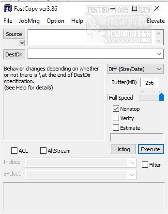

Thanks for a reply. I got no space to do that. I did however put some of the most important data on to another drive I had. Couldn't I just transfer the data to the new drive using a program that would be faster than Windows Explorer? I mean why put it on my PC which has no space for all of it when I can just put it on the new drive right away anyways?
https://www.majorgeeks.com/files/details/ultracopier.html
