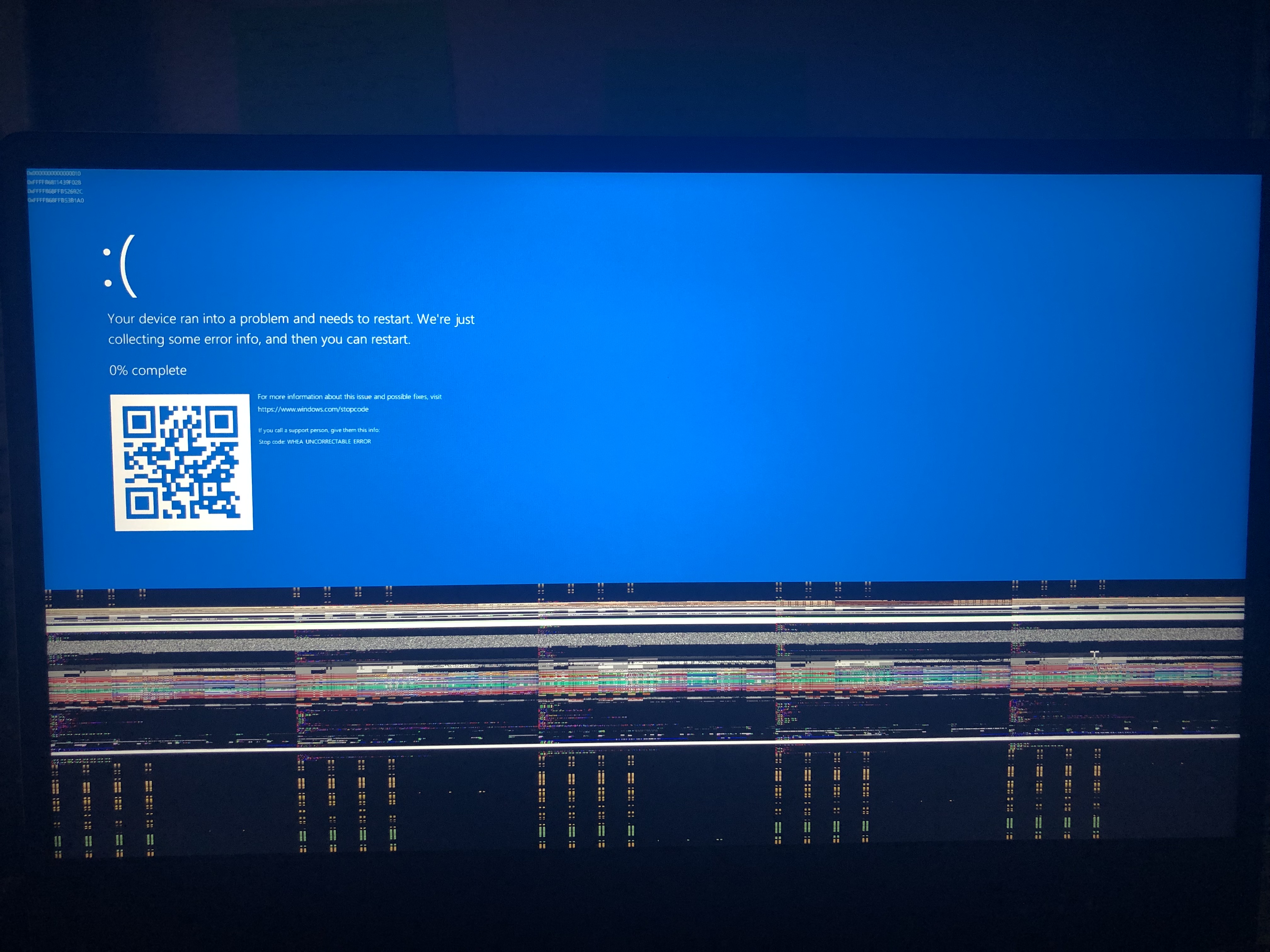

Hello all! I have a 2021 ROG Zephyrus G14 (GA401QM) that had previously been bluescreening roughly once a week. The hex code for the crash on event viewer included the name of my SSD, so I updated the firmware on it, and was crashless for about a month... up until now.
The stop code of the BSOD is WHEA_UNCORRECTABLE_ERROR, here are the parameters:
  • param1: 0x10
  • param2: 0xFFFF86811439F028
  • param3: 0xFFFF868FFB52692C
  • param4: 0xFFFF868FFB53B1A0
A dump file was not generated for the crash (Event 161 in Event Viewer), and under the event data section of this is the following:
\Device\HarddiskVolume3​
000000000100000000000000A10004C000000600010000C000000000000000000000000000000000​
Edit: I used DiskPart to see what HarddiskVolume3 was, it seems to be my recovery partition on my SSD... not sure what that means but hopefully it'll be useful info
I will attach pictures of the BSOD - idk why, but there's graphical glitching on the bottom of it. Should also be noted that this has only happened while the laptop was unplugged, though I'm not sure if that's just coincidental or not. If you need more info about the laptop please lmk!

Ohh ok my bad, I misunderstood what you were asking. Here's the dump file:
https://www.dropbox.com/s/f8k2xhiv4v3zz4x/011923-9937-01.dmp?dl=0
Image path: \SystemRoot\system32\drivers\wd\WdFilter.sys
Image name: WdFilter.sys
Timestamp: * Invalid (90D07890)

nothing suspicious, can you go to windows\system32\drivers location and check file info of that drmk.sys file? if it still says 1999 or got fixed with dism/sfc repair
Yeah! Here's the file info:
File description: Microsoft Trusted Audio Drivers​
Company: Microsoft Corporation​
File version: 10.0.19041.746​
Date created: 7/15/2021​
The stop code WHEA_UNCORRECTABLE_ERROR generally indicates a hardware error, and is often caused by a problem with the CPU or memory. The parameters of the BSOD (param1: 0x10, param2: 0xFFFF86811439F028, param3: 0xFFFF868FFB52692C, param4: 0xFFFF868FFB53B1A0) can provide more information about the specific error, but it's not possible for me to give a definitive diagnosis without more information.
It's interesting that you're experiencing this issue again after a month without crashes, and that it seems to be related to the recovery partition on your SSD. It's possible that there is a problem with the firmware of your SSD or some other hardware related issue.
You could try running a diagnostic tool on your SSD to check for any errors, and also run a memory diagnostic tool to check for any issues with your RAM.
It's also worth checking if your system is running the latest BIOS version and also if the system is running the latest version of your SSD firmware.
You could also try running the system on battery power and see if the issue still persists, if it does then you could look into replacing the battery.
Lastly, If you are still experiencing the same issue after trying all of the above steps, it may be best to contact the manufacturer or an authorized service center for further assistance.
When I first started getting the issue, I thought it had to do with the SSD firmware because the hex code in one of the related Event Viewer events contained the name of my SSD. BIOS is up to date, and SSD firmware is as well. The battery seems fine, but I'm mentioning the possibility because only my iGPU runs when the laptop is on battery. That + the graphical artifacting on the BSOD makes the iGPU looks sus, but I DDU'd the drivers for it awhile ago and it didn't help. Temps while on battery also seem fine, at most they're around 75C. I'll run some diagnostic tools later and see if they catch anything!
