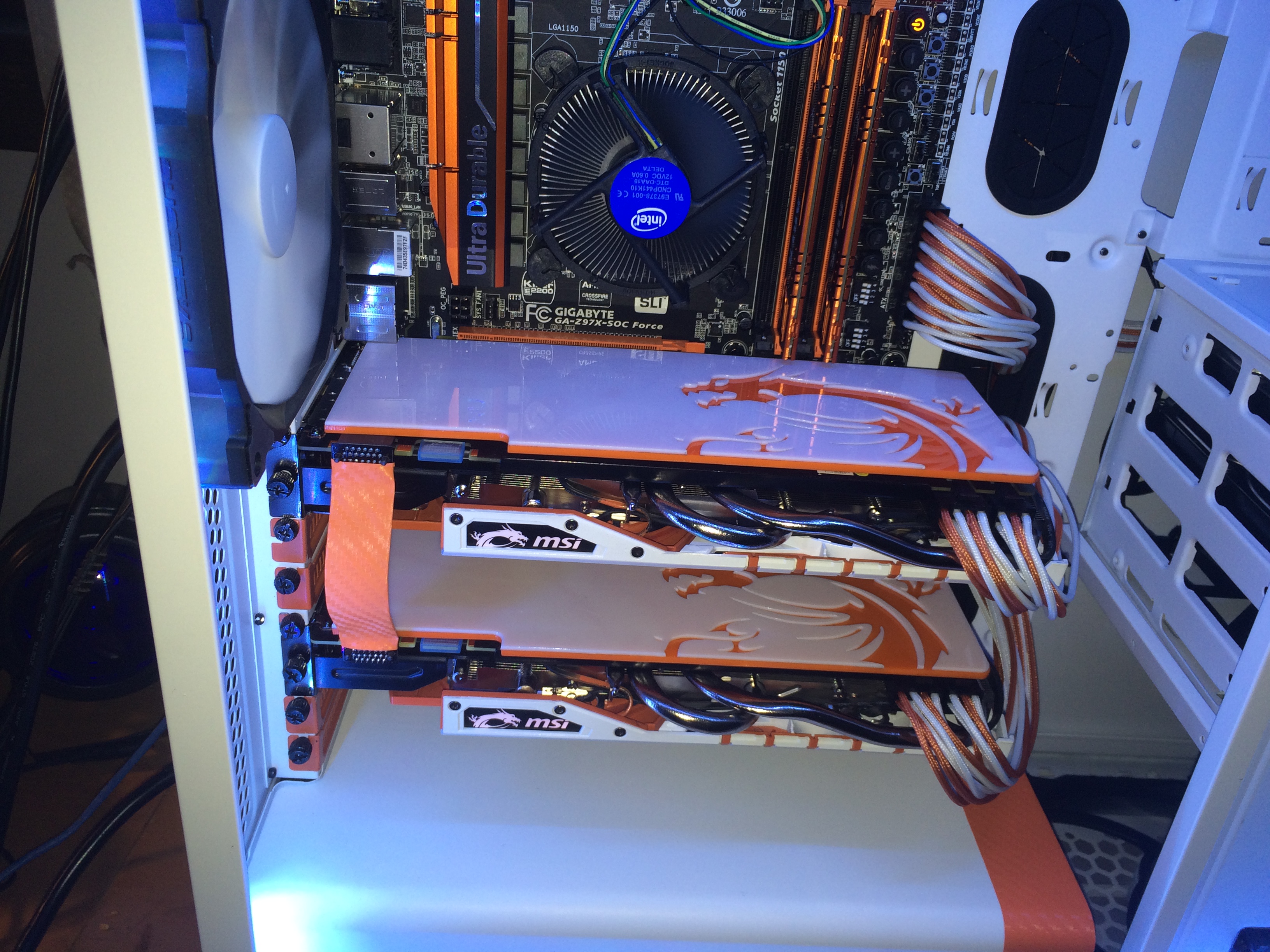

Here's a pic of Luxe w/ Air cooler and 7 fans
LL

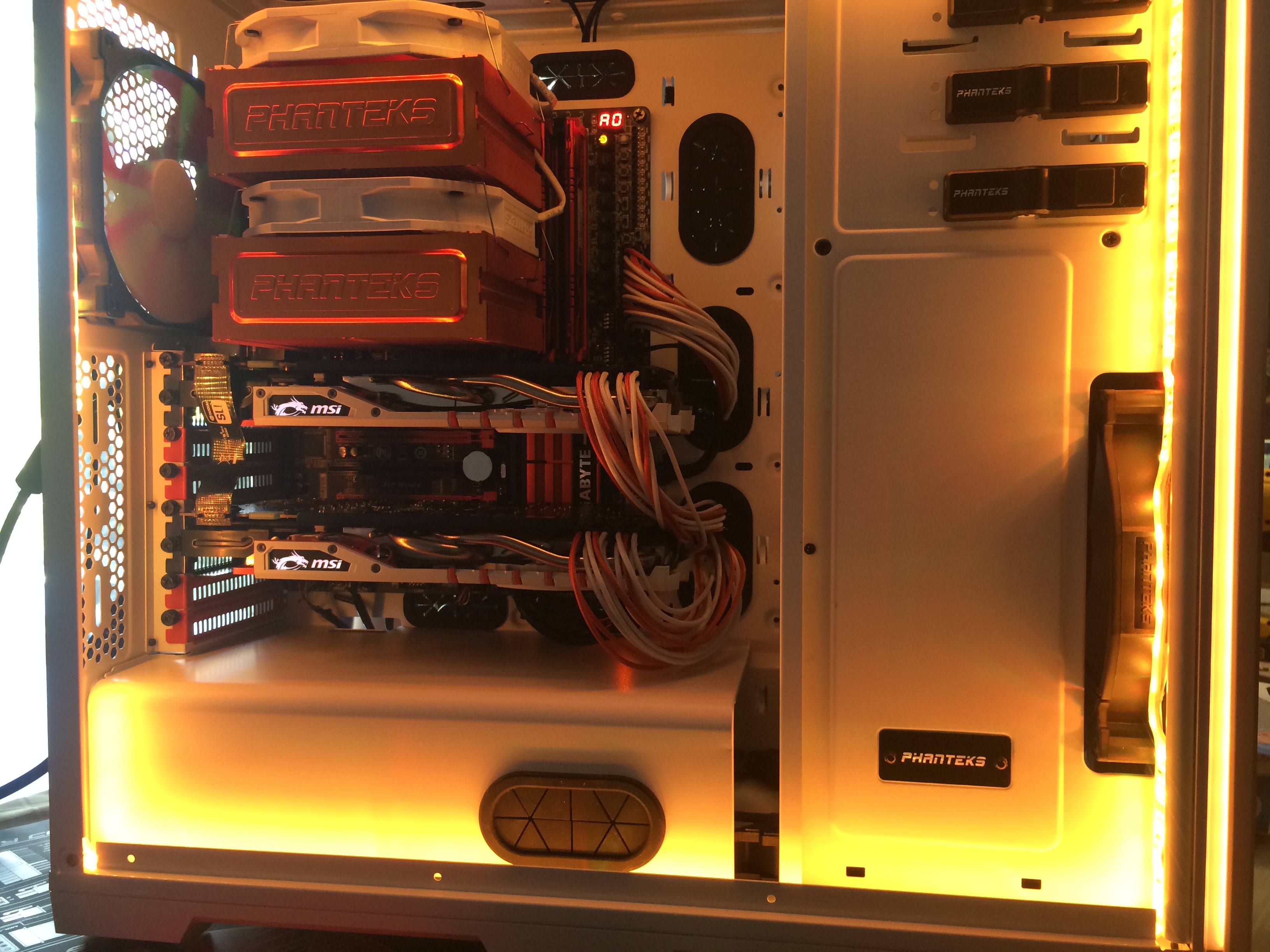

And here's another pic just before installing the Swiftech
LL
Again, what **I think** is what I told you in the above post. Always better to have more fans at lower rpm than less fans at higher rpm. To fit 2 fans on the bottom, you need to take out the lower HD cage and slide bracket. You get (2) 140mm w/ the case; if you need both HD cages I'd add 3 more and see how it goes....if ya don't need the bottom cage, 4 is better. You won't hear them if ya keep rpm at 850 or below.
You can also add (2) 120mm fans to the side of the HD cages to blow air between GFX cards
1. In the pic above, that's the Gigabyte SOC Force, as you can see the big air cooler had to be installed horizontally instead of the recommended vertically cause the cooler was hitting the top GFX card. That's one of the reasons it was sent back and swapped out for the Swiftech H240-X.

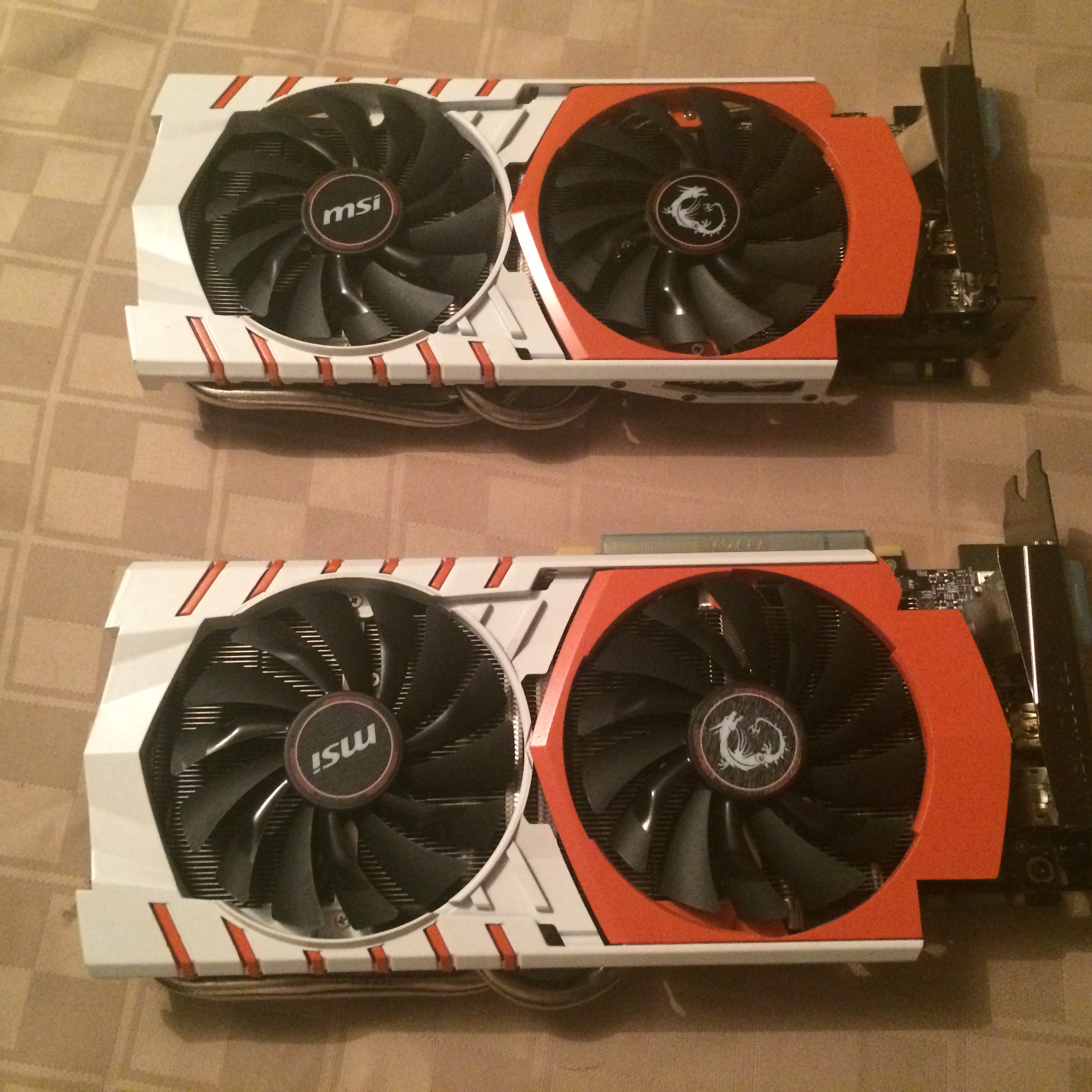

3. The 100ME GFX cards are about a half inch longer and with the green color it seems to clash with your RAM, and MoBo colors. Might wanna stick with the stock red version.

I don't care that the GPUs are green, tbh red and green might look pretty cool together. Plus, it's got a backplate, which could help, and it's limited edition, so why the hell not.

3. I don't think either is "better" as they each excel in different areas.
a) The MSI and Gigabyte both have superior componentry compared to Asus and EVGA
b) MSI and Gigabyte both outperform the Asus and EVGA cards routinely breaking 1500 boost clock. As for who wins between the two, Gigabyte seems to win more than it loses.
c) The Gigabyte is almost 2 inches longer making it a fit issue in many cases.
d) MSi has an edge on noise with it's ability to shut down the fans and even run one fan or two depending on load.
e) Which one I pick for particular build most oft comes down to what MoBo was picked. If it's an MSI Gaming 5, the MSI 970 makes more sense.... If it's an Gigabyte Gaming 5...the Giga 970 makes more sense.... That way if ya have an issue with either, tech support can't chase ya off the phone by blaming the other guy
