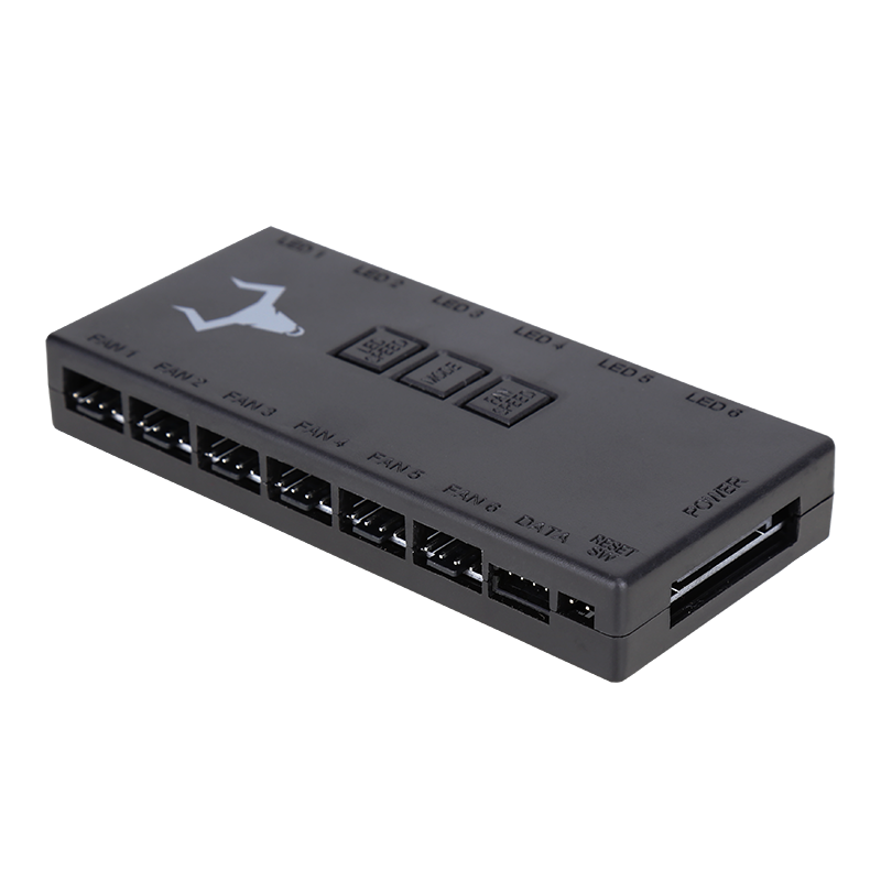

Today I built my first PC and everything seems to work fine besides the case cooling fan. It has also LEDs and they work but it just doesn't spin. I'm scared I messed up with cables and connecting them on the motherboard but I checked a lot of times and tried different slots but it still won't spin.
Maybe it's something with the controller? 'Cause yeah the case had the fan pre-built in and on the back there is a controller where the fan is plugged into and then you have to connect that into the motherboard. I tried connecting directly the fan to the motherboard but it doesn't work in that way either.

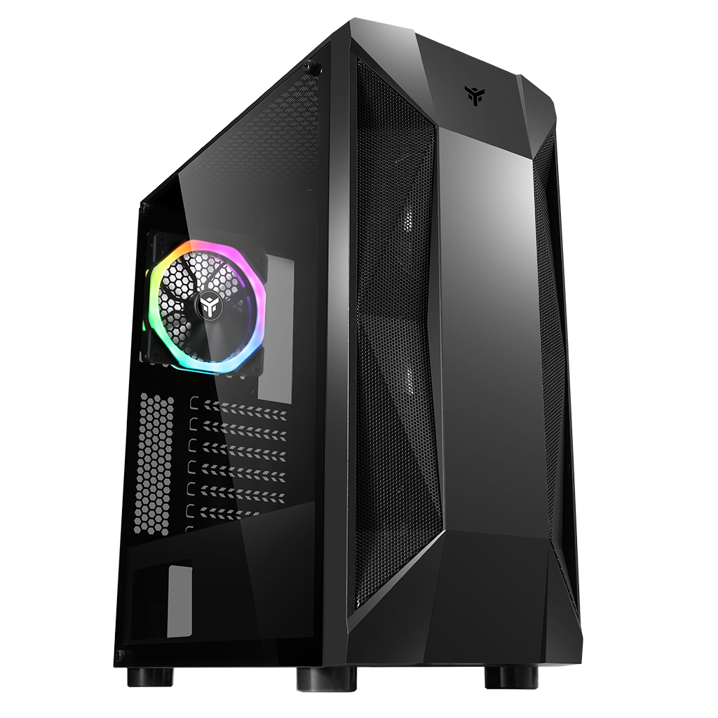

Please add images of the connectors of the fans and the controller that came bundled with the case. Also, try and take close up shots of the connectors of the fans. If they are the 3pin ARGB kind or the 4pin RGB kind you should be able to see an arrow on the connector, that lines up with the 12v/5v connector on the motherboard.
Images of the case;
shows it to come with one fan, that's in the rear.
EDIT: I fixxed it by removing the controller and plugging the fan cables directly into the motherboard. But now I have the white light on "BOOT" on the motherboard if I turn the PC on
Controller on the back of the case: https://ibb.co/vwQCNtX
*I noticed that it has "POWER" on the bottom part but I have nothing to plug into it
You plug sata power connector in there (coming from PSU)
or else fan controller will not function.
