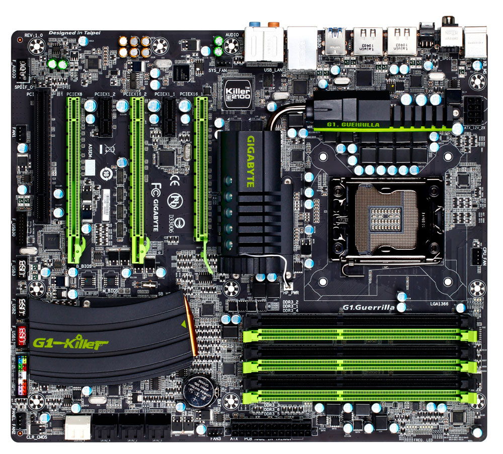

Hi there I was wondering if you could tell me if a Gigabyte GTX 770 2GB Graphics card was compatible with my Gigabyte G1.Guerrilla Gaming Motherboard ?
It's a 3 year old Mobo so I'm not sure but I hope someone will have the answer!
The last bios update was in 2012 so I'm not sure if it will work in my system !
Help
Thanks
James
Yes, it's compatible. Just read this carefully :
2 x PCI Express x16 slots, running at x16 (PCIEX16_1, PCIEX16_2)
* For optimum performance, if only one PCI Express graphics card is to be installed, be sure to install it in the PCIEX16_1 slot; if you are installing two PCI Express graphics cards, it is recommended that you install them in the PCIEX16_1 and PCIEX16_2 slots.

My old GTX 460 worked fine after the black screen with the GTX 770. I was so confused when it kept happening. The only thing I can think of is am I putting the GTX 770 in the wrong slot. But I just put it in the big green slot (there are 3 on my Mobo) and that worked for my old card so I thought it would work with my new card.

In my first post I quoted from the manufacturer that for optimum performance you should use PCIEX16_1 slot
