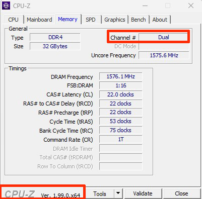

So I finally took my chances and bought a new CMK16GX4M1D3000C16 - VENGEANCE® LPX and paired it with my existing CMW16GX4M1D3000C16 - VENGEANCE® RGB PRO.
Good for me that they are running in dual-channel configuration as far as I can understand.
The latest version of CPU-Z (2.03) is displaying memory channel as 2x64-bit which got me little confused. So I had to check for some answers and found out that all newer versions of CPU-Z since version 2.00 are displaying CHANNEL as 2x64-bit.
I also checked with CPU-Z ver. 1.99 and few more older ones and they are displaying CHANNEL as DUAL.
The VALIDATION of every version (older and newer) I tried resulted in DUAL CHANNEL (128-bit) DDR4-SDRAM.
Posting a few images of my validation results here.
CPU-Z ver. 2.03 Results
CPU-Z ver. 1.99 Results
Just hoping if it could be of help to anyone still looking for answer.
Thank you once again for you time @Darkbreeze and everyone else caring to read this post.
"Something" is wrong. DO you have XMP enabled?
Because based on those screenshots your memory is running at timings of 20-20-20-38-58 when they SHOULD be running at timings of 16-20-20-38-58. Likely this is because they are different sticks.
You might want to try manually setting the CL latency to 16 rather than 20 in the advanced memory timings section of your BIOS. The difference between CL16 and CL20 is pretty significant and it likely why you are not seeing any improvement, in fact, you might see a REDUCTION in performance if your original 16GB kit WAS running at CL16 before.
No, not XMP, but I have manually set the RAM Frequency to 3200mhz, as I was running my single RAM stick at 3200mhz. Actually I didn't even touched in the BIOS after installing the new RAM stick. Just checked in the task manager and it displayed 3200mhz. And then in CPU-Z. That is all.
Since both these RAM sticks are 3000mhz sticks, XMP will run them at 3000mhz and I'm running them at 3200mhz, I didn't wanted to downclock them.
Should I switch to XMP from manual 3200mhz? Do I still need to tweak the CL Latency manually if I switch to XMP @3000?
So I switched DOCP (XMP) on in BIOS and tried CPU-Z validation again and got these results now:
CPU-Z 2.03
CPU-Z 1.99
The timings are now 16-20-20-38-70 but still not 16-20-20-38-58.
Should I still tweak the latency manually?
Now it is right. And now you should probably see some amount of gains in performance. The last timing, you can certainly TRY it at 58, but do not be extremely surprised if it doesn't like it. It's fine though, it is not a huge inconvenience to have to start over with your BIOS configuration if doesn't want to POST with that setting. You can always just remove the CMOS battery to reset the BIOS if it won't train or doesn't automatically revert, and then reconfigure it again. Also, you can play around with the settings a bit to see what works but if you make manual changes to your memory configuration and it DOES POST, it's a very good idea to test the configuration with Memtest86 to make sure it is stable.
Truthfully, considering you have two different DIMMs, you might not be ABLE to get that fifth timing down to 58 but you can certainly try.
You'll find some instructions on testing the memory configuration towards the end of my guide at the link below. I'd really only be worried about running four passes of all 7 tests in Memtest86.
