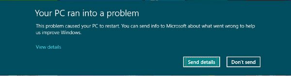

The problem isn't not sleeping in idle states...It's just when I click "Sleep" it just turns off the monitor and after about 10 minutes whole PC turns off and nothing works. After powering it on with the power button, it boots from scratch and gives the error.
The error is like this:
http://www.computerandyou.net/wp-content/uploads/2013/03/Windows-8-Retstart-issue-2.jpeg
sorry for not being clear before.
Checked the requests, nothing.
And nothing is shared. I have removed Homegroup and have disabled all the file and printer sharing options for all users just to make sure.
Also sleeping while media is being played is allowd.
let me know if we are talking about the same issues now.
so if I got this right: you have two issues:
why does it take 10 min to put the system to sleep when it should only take less than 30 seconds
and 2, why will it not wake up from sleep?
on my machine:
event
1. i select sleep
2. 2 seconds later the monitor turns off
3. 30 seconds after that the CPU and case fan turn off
4. I hit the space bar
5. 2 seconds later the monitor is on and I can start typing.
so in your case: 1 and 2 are the same, number 3 happens but takes 10 minutes
and you can not wake the machine with the space bar?
So the question would be why is it taking 10 minutes to turn off the system/cpu fan
and why can you not wake the system with the space bar?
I would check the sleep setting:
in your control panel power options setting, advanced settings tab, look in the sleep section, expand allow hybrid sleep
and check to see that it is on.
now when your system goes to sleep it will be in the correct state.
I think your system is sleeping, I think is taking too long to sleep and is not waking up.
First question would be what kind of keyboard do you have connected. (usb or ps/2 type)
then I would check the BIOS to confirm that your BIOS power management does not completely power down the USB ports/hub
then I would also check the BIOS to make sure it is set to wake via keyboard space key.
if you find that the computer fans do turn on when you hit the space key but the screen does not come on. Then look for a BIOS setting that
says something like repost vga after s3. the newer monitors also have sleep circuits that turn the monitor off after a timeout period. It is set in the monitors firmware. Some monitors will not turn back on until they see a signal from the computer on the video line. The bios setting will send that signal.
otherwise you might have to unplug and plug in the monitor video cable to get the monitor to wake up.
