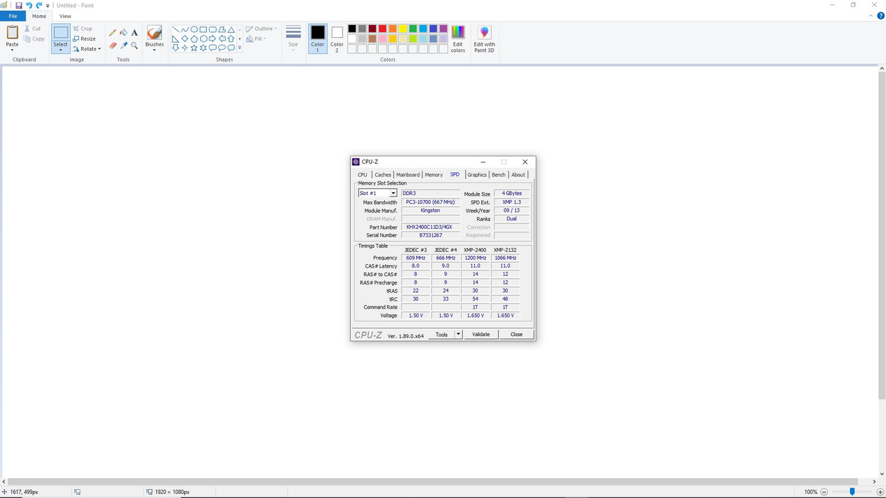

here is the picture of the cpuz
https://i.postimg.cc/TPcVBrzw/ram-1.jpg
look at the spd one, its showing 2 ram as xmp but the other 2 as jedec, im confused by this as i have 4 ram but it seems i have only activated 2?
That's not all your ram, that's showing specs for a single stick in slot #1 out of 4. This memory module has four profiles, the standard Jedec speeds of 609 & 666 and then Xmp 2400 & 2133, going left to right. Currently, speeds for all ram is running at 2133. 1066*2 under memory tab = 2133 DDR.
Xmp 2400 should be faster.
Kingston Hyper Beast 16GB PC3-12800 is 1600MHz ram, you actually have PC3-19200 version.

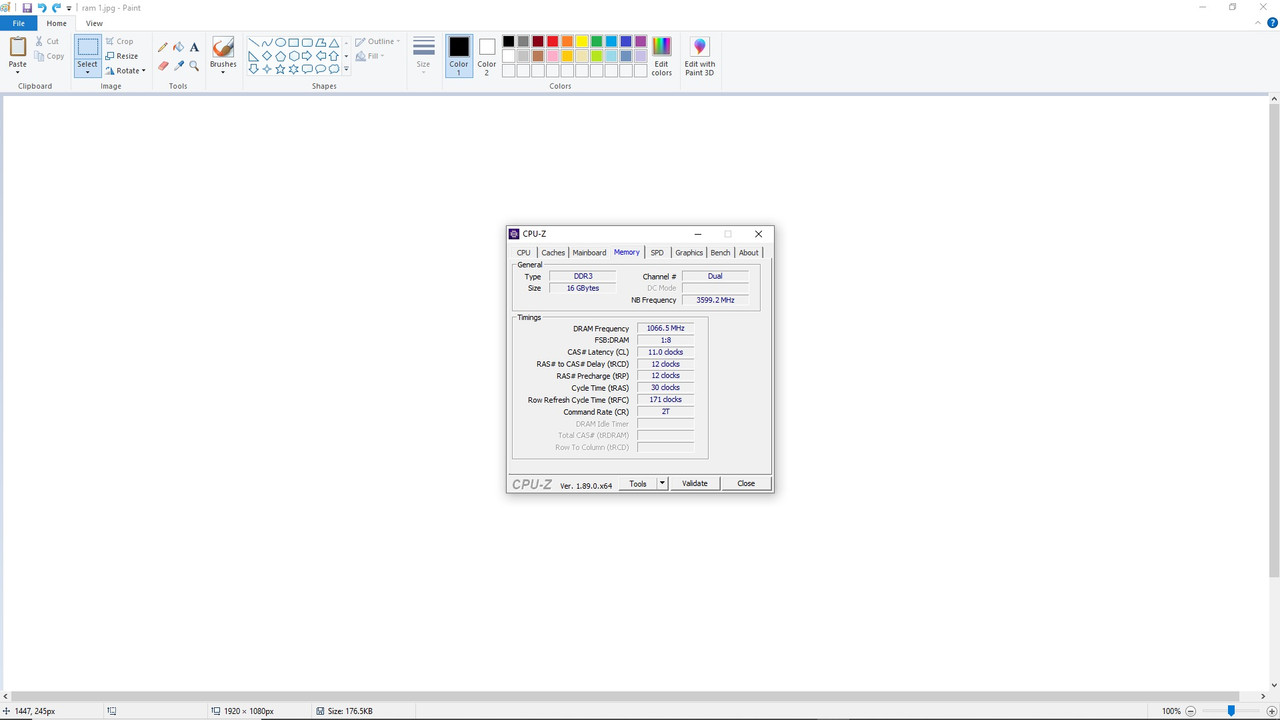

how do i change it to xmp 2400?
its quite strange but it shows profile 1 as 2400 but profile 2 is 2133.

They compare equal hardware so 2133 ram will be compared to 2133mhz ram, the same for 2400 means that you can't compare 2133mhz to 2400mhz via their tool.
