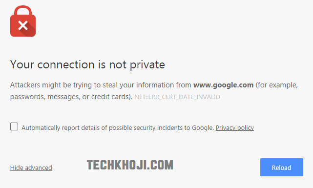

Here is a picture with the same error that I get:
http://www.techkhoji.com/wp-content/uploads/2015/08/Your-connection-is-not-secure-android.png

NET::ERR_CERT_DATE_INVALID
That's exactly the error I get.

I can not imagine that using a different language pack would cause this kind of error. If the date and time, and the timezone are all accurate, then that should not be the problem. You have certainly found a tricky problem. I will do some more research. In the meantime, have you run a full system scan with Kaspersky lately? Maybe try Malwarebytes as well. I think that I may smell something foul here. The picture that you posted says "ggogle.com" and yet the details that you provided say "yahoo.com". This may be a virus. Was the detailed information from clicking on the error report from the same page as the picture that you posted?

Oh sorry, about that, it was my fault actually.
I've posted that picture because it was in english, so you guys could understand.
As I said I'm from Brazil, and the Chrome errors are shown in portuguese.
The information about yahoo.com is mine.
Sorry for the miscommunication!
