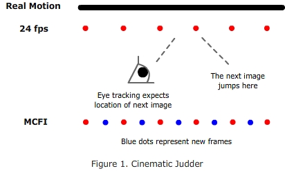

Also, if the motion is faster then 60 pixels per second, or is variable, it is much better with more Hz I think. Then the frames can "hit" a screen refresh twice as close, and you get less judder in variable fps (which applies to both pcs and consoles today). So i'd say 120hz is the future. We just need more HDMI bandwidth :)
