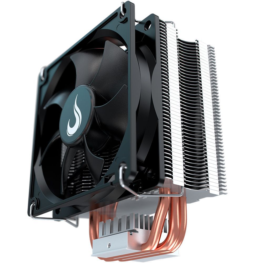

What cpu cooler do you have?
A simple air cooler...

With the tower cooler you have a drop in the middle is not sufficient.
The cores are closer to the edge instead in the center center.
The small grooves along the edges of the heat pipes will use up most of the paste and the edges do not get covered.
A thin line x pattern or x pattern of dots is best for your type of cooler.
