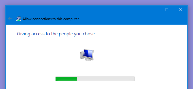

Well, I've managed to connect to the Network A while being on network B.
I set up port forwarding and i see incoming connection on my virtual server on Network A. But still i cannot see the PC from network B while on network A, and vice versa as well.
I have followed this tutorial.
Any hints why i cannot see these shares? how do i access this PCs?
The network neighbors thing will not work when you are on a different network. You can just mount devices via IP address and it will work. This is one of the function of a domain controller in microsoft server networks. It lets you see other machines when you and not on the same local lan segment
