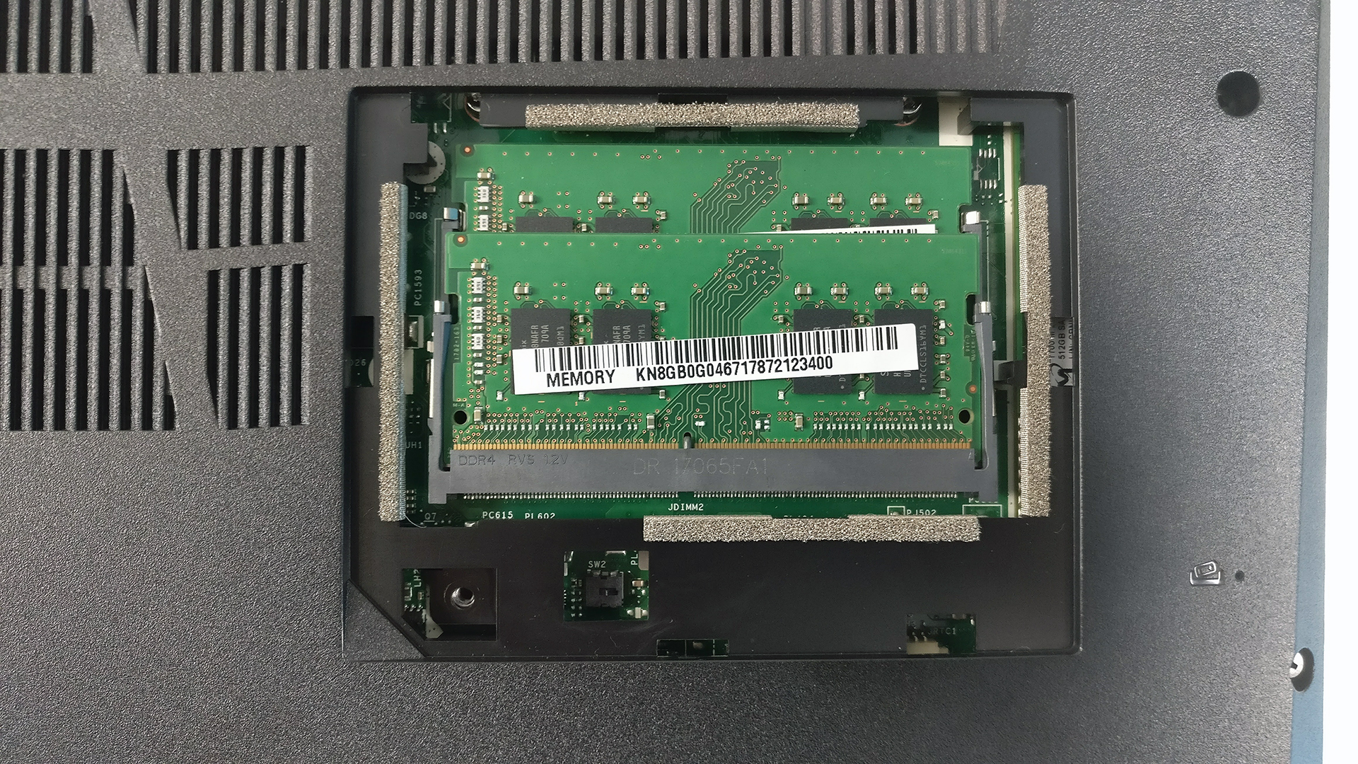

Sep 22, 2018
I had the same problem about a month ago. Got in contact with Acer support over e-mail, technician came in next day and the problem was that a switch ( photo attached ) was getting blocked. He just toggled the switch manually 4-5 times and everything was fine. The process is easy and on can do it themselves as well.
1. Remove the lid over the RAM slots
2. There will be a little sliding switch below the ram sticks.
3. Just slide the switch back and forth a few times and check your laptop after that.
Tell if that helps!
