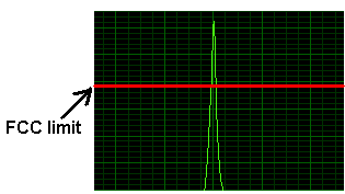

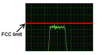

um... actually no, spread spectrum looks something like this graphically:
Without Spread Spectrum
With Spread Spectrum
In short, Spread Spectrum spreads EMI across wider range of frequencies. your whole "rounding off corners of boxes" concept didnt really make much sense. and spread spectrum usually impede OC capabilities.
