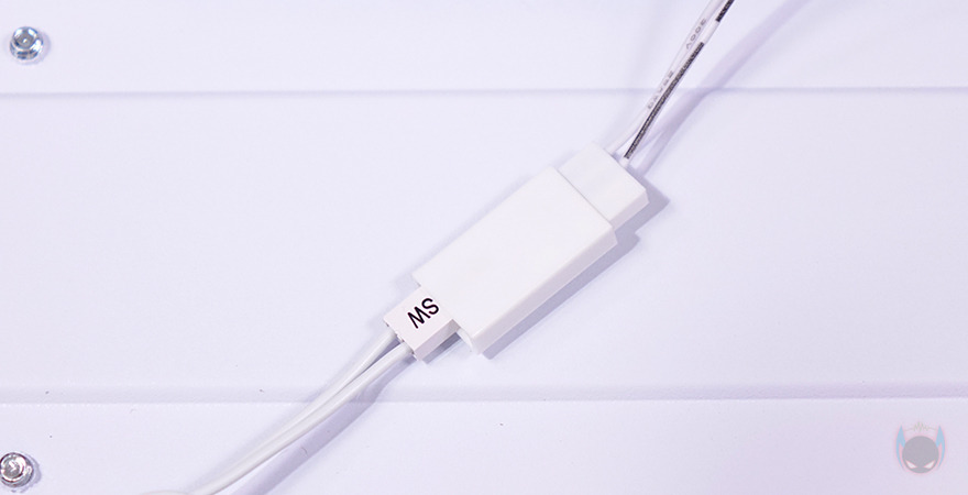

Hello everyone, I just finished building a new PC using the case mentioned.
As far as I can tell, the small button near the power button can be used as a on/off switch for the RGB LEDs or as a restart button (if connected to the motherboard).
I want to use it as a toggle switch for the RGB LEDs but for some reason, when I press it it just doesn't do anything.
I'm not sure where should the cable coming from the small button (with a female header labeled "LED SW") be connected to?
Thanks!
your motherboard doesn´t support this on off switch. Only way to plug it in would be directly to a RGB hub, where the LEDs would be connected to.
Check if the fans of the case have such a connector. If not, an addon would be needed.
e.g. https://forum-en.msi.com/index.php?attachments/case-png.182515/
Thanks for the quick reply.
One of the case's fans has an extra wire that was connected to this wire when I just opened to box and saw the case for the first time. While doing the cable management, I disconnected it.
Putting it back in place didn't do the trick.
