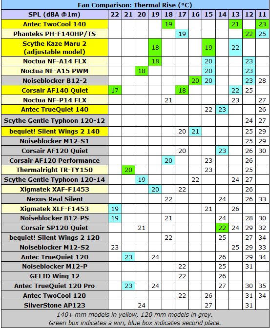

Yes, Noctua's ruled the roost .... in the older posts. Then this happened ... Phanteks took them by 3C.... and while spinning 300 rpm slower. The F140 is the fan design....the letters after it the mounting frame s there are frame designs for coolers, versus case and PWM versions (XP)
http://www.overclockersclub.com/reviews/phenteks_f140/3.htm
They also took silentpcreviews top honors....the antec was quiet at full bore but had annoying ticking / hum noises at slow speeds.
700
http://www.silentpcreview.com/article1345-page7.html
The Phanteks PH-F140HP/TS is the clear winner in every respect. It edged out the new Noctuas every step of the way, delivering the best overall results of any fan we've tested thus far. To top it off, it had cleanest, smoothest sound of all the new fans in this roundup. If we had to start from scratch, this might be our new reference model.
