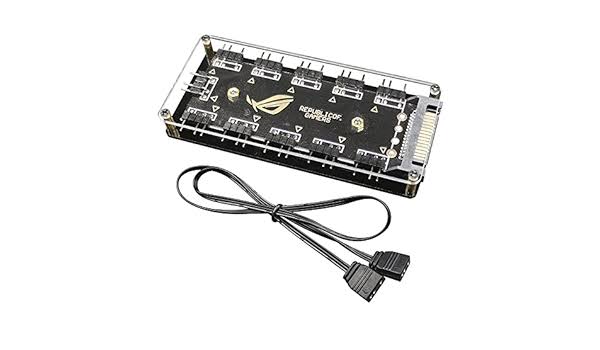

Hi so i recently built a pc and chasis fans and cpu cooler are argb. Unfortunately for me, my mobo doesnt have an argb hub (ikik i bought the parts AFTER i bought the mobo and then couldn't replace it) Either way, i was wondering if i could buy an argb hub specifically this one, can i just use sata from psu and connect the fans's 3pin connector to this and use a software to get it working? Cause most people I saw were using the hub as an extension to connect all fans to main first fan rather than a supplement for lack of headers. So idk if it'll work or not without the 3pin connector and just the sata.Any help?:/

Not that one, hubs don't have an ARGB controller, they are just distributing signal from MB. What you need is full fledged ARGB controller that has at least USB connection to control lights thru software.
Something like this

yeah i did some research after posting and realized it will only power up the leds and not give me an option to change the leds as that would need a 3pin connector which my mobo doesnt have. these corsair/razer hubs are expensive af if i was gonna spend that much i couldve bought a better mobo lol, currently thinking of goin with a hub that has a remote im guessing that would work?

Yes, those with remote (wired or not) will work but can't be controlled by SW without some connection with system. That Razer one is among cheapest.
Don't feel bad, I've done the same kind of thing. I'd buy the less expensive thing to 'save money' then realize afterwards that I want something out of it that means I'm actually going to be spending more money than if I had just bought the thing I wanted from the start. My understanding is that an ARGB hub is really just a component that allows you to connect multiple RGB devices. It doesn't give you control over them. That's why hubs are relatively cheap. Controllers are like smart hubs, they allow the connection of devices AND control them. That's why they cost more. The truly expensive stuff is the proprietary stuff, like from Corsair. Fans and controllers have to be from the same company .
