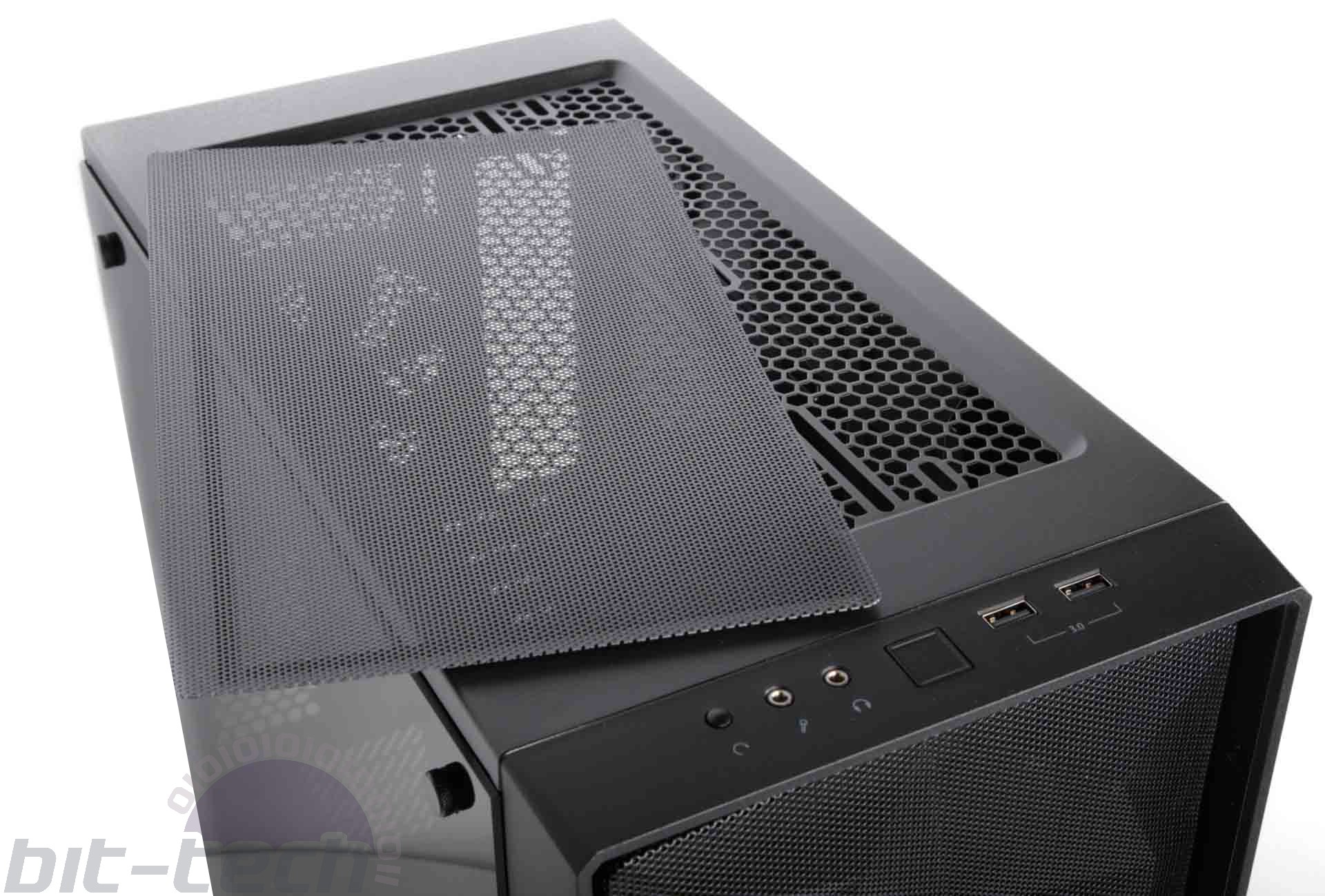

Meshify C Mini comes with 2x removable filters and 1x unremovable filter. Top and bottom filters are removable while front foam filter is not and is built-in to the front panel. Images too, click on spoiler to view:
Top filter
Bottom filter
The thing with stock filters is, that they have way too big of a holes in the mesh, making them less effective. That's also a reason why i use custom filters. In this video review, stock filters are compared to the Demciflex filters,
