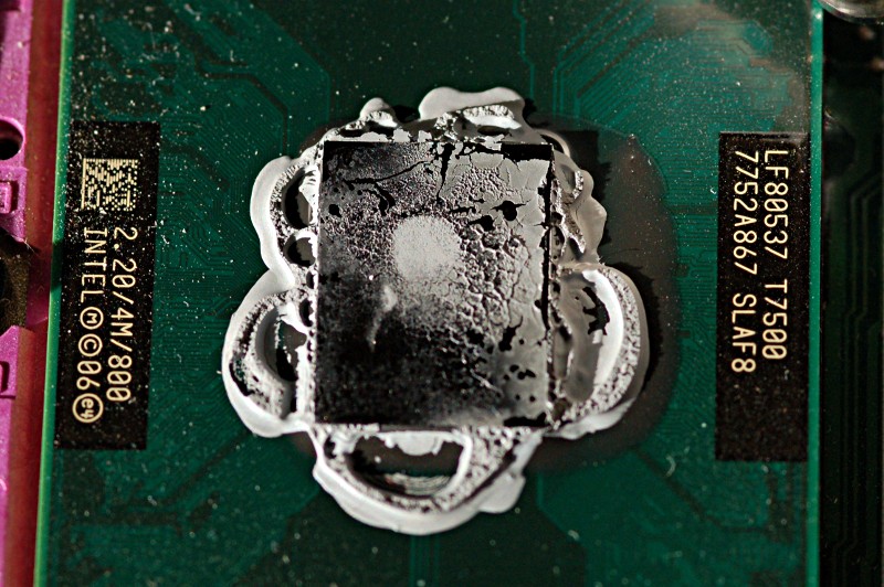

In spite of all that, the temp shot up to 93° C when I started transcoding a DVD (before I aborted the process.) I cleaned that up and repasted with a small drop of AS and temps now rise slowly to 80° C when transcoding.
As for souping up cars... I ws very happy to have my sons souping up PCs. Crashes were much less painful!
I can warm my lunch. 😉 My T500 only goes to 73° C when transcoding, but I think it is 45nm vs 65nm tech. It would not surprise me if the Mac had better cooling.
Try undervolting , my x-9000 and t-7200 run max 60-63c running 100% with WCG boinc , undervolting and OCZ freeze dropped my temps 10-15c from stock , used to run at 70- 80c . X9000 is running at 3.4 Ghz . Took a while to get it set and run stable , but worth it .
That is what I saw from the factory , unreal ! Is it any surprise so many laptops die in 1-2 years ? Between dust buildup and paste application like in your picture it's amazing they last that long . Heat kills , I know a cleaning every 2-3 months drops my temps at least 5c .
