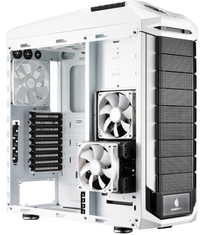

Just upgraded from a Antec 900 to this beast along with a modular psu, essentially a stormtrooper in white with a few adjustments. Never changed case before so I'd like some guidance on airflow setup before starting!
The 2 frontal fans are rotatable 90 degrees, think I should have them facing the front or the side? Should the airflow just be in the front/out the back or what? Anywhere I should slap some fans from my Antec in there? I'd like a cool GPU as I'm gonna SLi 570
Using a H70 cpu cooler btw! (cba to upgrade to a h100 atm)
Cheeeeeers
