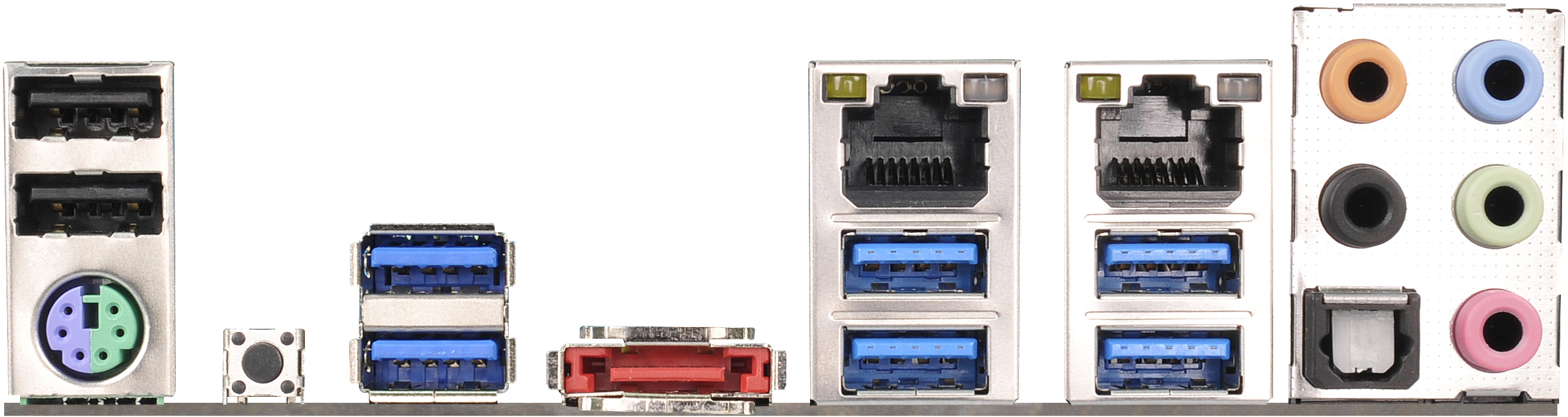

i was wondering if Gigabyte b450 aorus m ,would support gtx 1660 super, cant find any info if its supported,since i want to upgrade to ryzen 5 2600. currently i have b85m-g. dont know what they are called but are side ports (where you plug hdmi cable or other stuff) the same size as in b85m-g ?
HDMI ports are standardized. They can be in several form factors:
micro HDMI​
mini HDMI​
HDMI​
Anyway - you can not use HDMI port on Gigabyte b450 aorus m with ryzen 5 2600, because ryzen 5 2600 doesn't have integrated graphics. You'd have to use HDMI on graphics card instead.
Thank you so much for taking your time and replying to my post! i already have gtx 1660s so yes it does fit in my case, and i was talking about all this, these look a bit different than on b85 so i was wondering if this row of idk what all this is called,is the same size as in b85 so it fits at the back of my case, idk maybe im overthinking this but i want to be sure.
