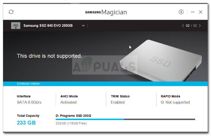

try running this on the ssd - https://www.samsung.com/semiconductor/minisite/ssd/product/consumer/magician/

Thank you for reply. I already had Magician and it says, on every startup: "An error occured during execution of scanning. Please check and try again." then it says "Magnician can't verify SSD. Please check network connection". Maybe i got it outdated though.
