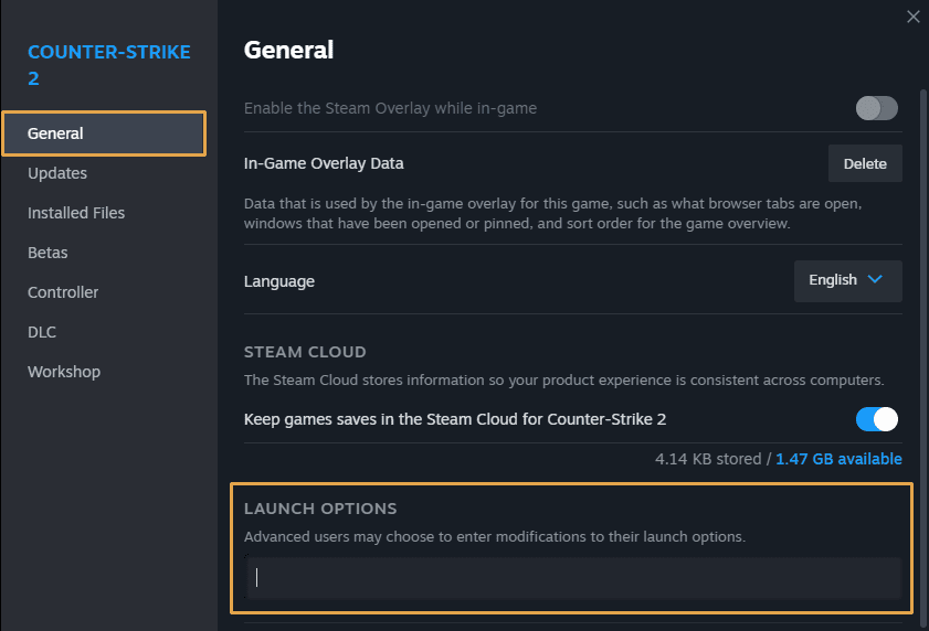

If the game still doesn't launch, and is stuck on the loading screen, then use some command line launch parameters instead. Open up Steam, go to Library, right click Counter-Strike 2, and click "Properties". Then, click "Set Launch Options..." to open up the launch options window.
Try using these one at a time, and then start the game:
-vulkan
(This switches your game's rendering API from DirectX 11 to Vulkan).
-autoconfig
(This launch option will force your game to start up with the default configuration settings for the game, and you can change the settings in the game's menu once the game has started). Restores the config file settings to default.
-w [width] -h [height]
For example, to set your resolution to 1920x1080, you'd use the following launch option: -w 1920 -h 1080
-window (or -windowed, -startwindowed, -sw)
(Launches the game in windowed mode).
-novid
(Will disable the intro video).
