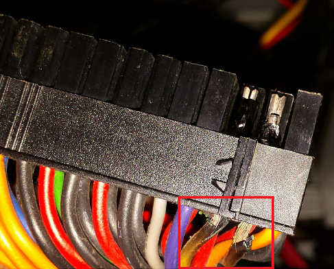

With PC's drawing to much power from the motherboard can melt the
12 volt pins on the 24 pin atx connector. GPU's didn't limit the power drawn in the past from the PCIe socket.
Melted 8 pin cpu connector (multiple pins) and 24 pin connector (just single pin)
Melted 8 Pin picture.
Melted 24-pin picture.
A faulty PSU can also cause this issue.
Burnt 24-Pin connector and random shutdowns Reason here, It's a bad wire to socket connection I suppose and it's a good idea to get a new PSU before you break something... I was told it was either a bad connection or my power supply just overheated and over-volted on the pins causing the first bsod. People can do this easly by overclocking a CPU or with sli setups. This is why getting enough power is more than a good idea. Why overclocking old systems with old PSUs can end in a burning smell.
