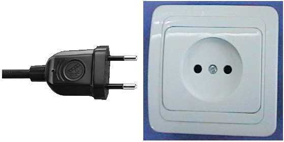

All the wall sockets in the house are like this

Yes, that power strip is grounded, and is actually a decent unit for what it is, but being plugged into a non-grounded outlet means that it is not grounded as well. So the grounding on that power strip is effectively non-existent.
I think your cheap power supply is the far more likely culprit though. Your room socket can't be grounded without running a ground from the socket back to the main panel, and then installing a different outlet in your room that incorporates the ground wire. Usually that means just running a whole new wire run that has the ground included.

I have seen this problem before, actually, there are a few potential causes. Cheap or faulty PSU. Bad static buildup from specific types of carpet. Poorly or not grounded outlets or circuit. To me, that is an ungrounded European style outlet. Grounded outlets will have either two contact points at the top and bottom or a pin that sticks out on the top. Often, those were only used for "wet" rooms. I don't think it's likely to be a problem here, but you never know. Considering you are in a less regulated area there are any number of possibilities including a poorly installed electrical circuit from the panel to the outlet or at the outlet.

I disagree. All PC power supplies have a measurable amount of leakage current. Even the better brand name ones. If the PSU isn't grounded, you'll feel it through the chassis.
Only a medical grade power supply, with leakage current as low as 0.5mA, is going to guarantee that you don't feel a "tingle" when the system is not grounded.
