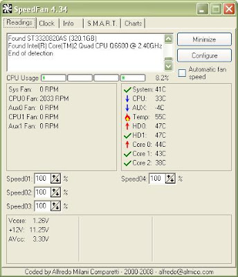

Well i start up speedfan and all I can see is my GPU temperature which is at 47 degrees, no option to change the fan speed or check the temperature for my cpu.
see if you can get the temp with this
http://cpuid.com/hwmonitor.php
you see where it says (speed01:100%) etc, try lowering each to 60% to know which 1 controls the cpu fan

SpeedFan showed that the TMPIN1 was runnning af 99 deg. celcius / 210 deg. F.
The CPU didn't get warm though so I expected something else was wrong.
Several restarts later I tried running CPUID that showed the internal temp. of all 4 CPU cores (i2600) and they were low (30 deg. C).
TMPIN1 is reading 35 deg. celcius now... much better:
