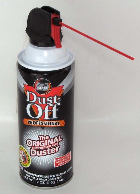

Techgeek i really didnt get this.part
Hitting the sink with compressed air
What do u mean by that and hows it done?
A detailed explanation used be really helpful man.

OK lets start at the beginning. When cleaning you system with compressed air (in a can) like this:
This is only an example of one product, I'm not saying you need this exact companies compressed air.
When you use compressed air to clean your system always be careful when spraying it at or near fans. If you get the fan spinning too fast damage can occur to the fan and result in having to replace the fan. My suggestion is, if it's easily accessible, put your finger or a pen / pencil in between the fan blades while you spray the compressed air. This will stop the fan from spinning altogether. If that's not possible, then use short blasts of air so the fan doesn't spin too fast and leave enough time between each blast for the fan to stop spinning. So by "hitting" it with compressed air, I meant directing a blast of compressed air at the heatsink. The blast should dislodge any dust that has accumulated on the heatsink exposing the metal of the heatsink to air. Dust is a fantastic insulator and will insulate the heatsink and impede the transfer of heat into the air, thus causing overheating.
I hope this was detailed enough.
