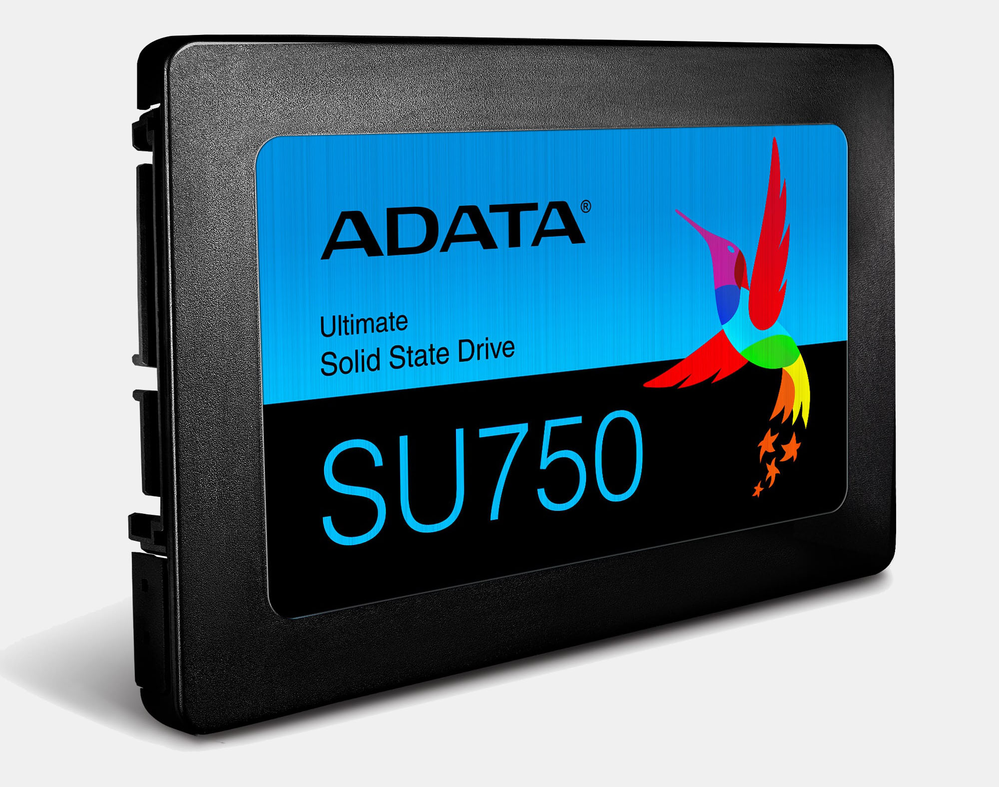

How is it connected? Sata ii? Iii? is it transferring at the speeds it should? I plugged my second SSD into a sata iii port that was hooked up to a secondary chip. Instead of getting 450MBps R/W i was getting 300ish. A test like you ran would have shown me all green. But once i saw the sub scores i knew what the problem was. I suggest doing what has already been suggested.
Check it with CrystalDiskInfo or similar tools.
I belive it is sata iii, and I will test it right now with Crystal
That's info, where is mark? I'm looking for something like this, the first program.
What are the read/write speeds?
if you don't mind me asking, how do I get it to tell me the speeds? Never used mark before and it is showing 0s across the board
Reads are fine, writes are slow.
His are around 300MBps, should be closer to 500MB if not higher. Like everything in his system it's off.
