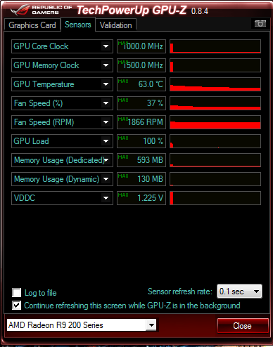

How looks GPU temps ?
You can use this to check http://www.techpowerup.com/gpuz/

here is what it said when my computer restarted i couldnt get a pic of the actually blue screen because it reset so fast. thanks for the help!
