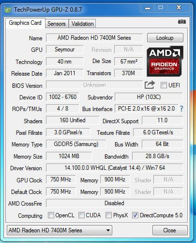

hi
i have a question:
when i use GPU Z to see my GPU MEmory clock i see this :
but when i use sensor in stressing my gpu gpuz show me this :
seeing?
my Gpu memory clock dos not over to 900 mhz and stay on 243 mhz
what's happened ?
why ?
plz help me
icant speek eng currectly
sorry
You should post a new thread on the forum to get this better answered. Also, do not forget to put the specs of your RAM and Motherboard in the post. Need the make and model of each.
