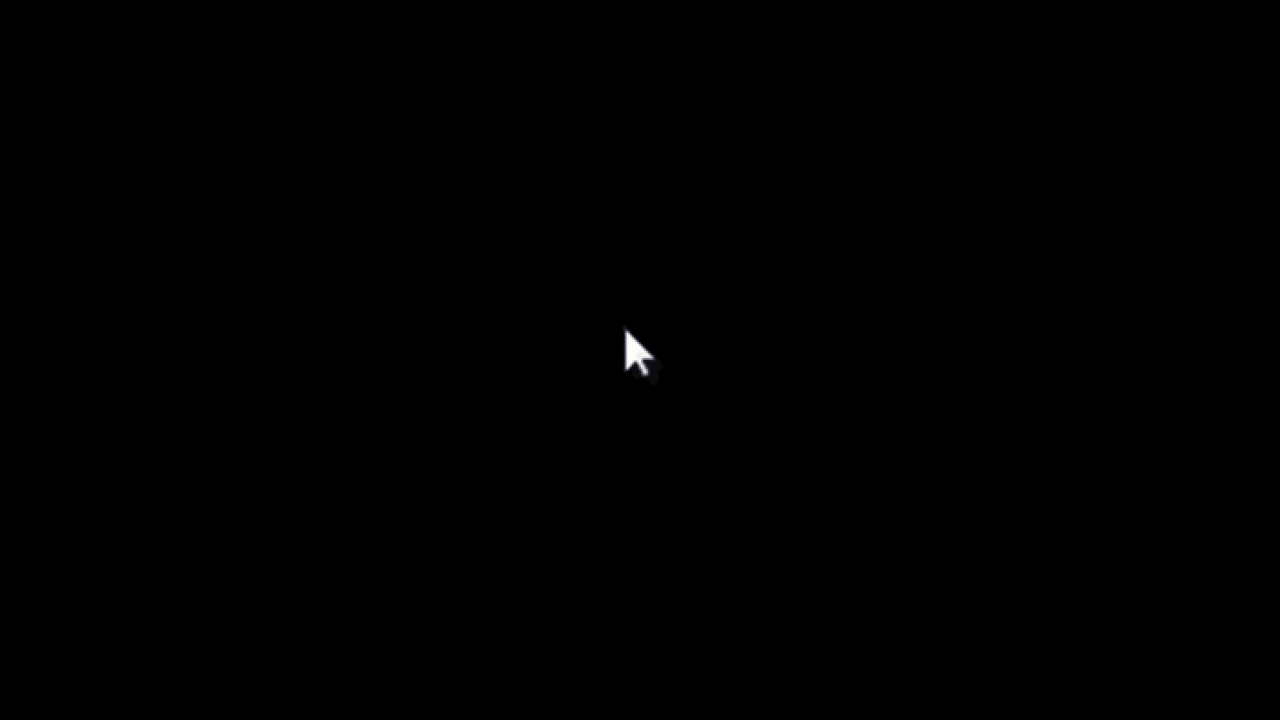

Yesterday, I touched the metal pins of the Riser with a metal Vacum by fault while the pc is running, but nothing happened, My PC still running about 5 hours perfectly (surfing web and Mining without any problem), after 5 hours I get some errors like gpu disabled, I restarted pc and re-enabled it, and it worked, after that I get some error and computer restarts few times, and Stuck in Repair mode boot loop (Black screen with cursor), I tried to restart few times, and tried to install fresh win 10 from USB, but some times it shows me Blue screen with cursor while start installation, I success to remove the black screen and show options to repair windows, but all options failed, I tried to connect my SSD to another laptop, and rescue some files, I found some files get damaged like(windows folder), so, I run CHKdisk utility and repair the SSD, I'm also found that there is a 500MB primary recover partion and have tried to format it.
Now, I can't install new win 10 (Blue screen with cursor while start installation) even when I try to change the UEFI to Legacy nothing happen, also, my SSD refuse to connect to my laptop, it start to appear and disappear few times, but the 500mb primary partition can appear and format, the ssd can boot into repair mode but shows black screen again and options don't appear.

I disconnected the empty riser, also I removed RX570 Gpu from motherboard,
When I connect SSD and boot from USB the installation screen dosn't start ( it shows blue blank screen with cursor when I press shift+ F10 it shows cmd, and check disks I don't found my SSD)
when I try to connect external HDD to USB and try to install Win 10, the setup works normally and HDD appears in Setup
the SSD can boot in repair mode (also shows Black blank screen with cursor without any error)
