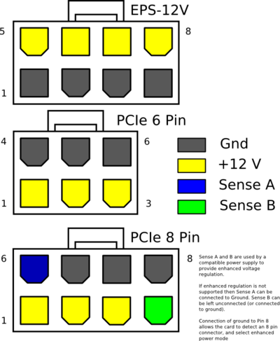

there is a way, 8pin eps is split to 4x4, right side of 8pin eps would fit
main-qimg-d0b098e598dd5de28261e6323a1fe572
you wont even need to rewire it...huh
but getting properly wired cable is impossible, wiring is correct, but 8pin eps to pcie kinda uses wires from both eps sides...so
get 8pin eps cable, get 4pin eps to pcie 6+2 cable
disconnect all eight wires from 8pin eps, switch wires from 4pin eps to that right side of 8pin (4x4) eps
or you could just get 2x molex to pcie cable....you do have molex, right?
