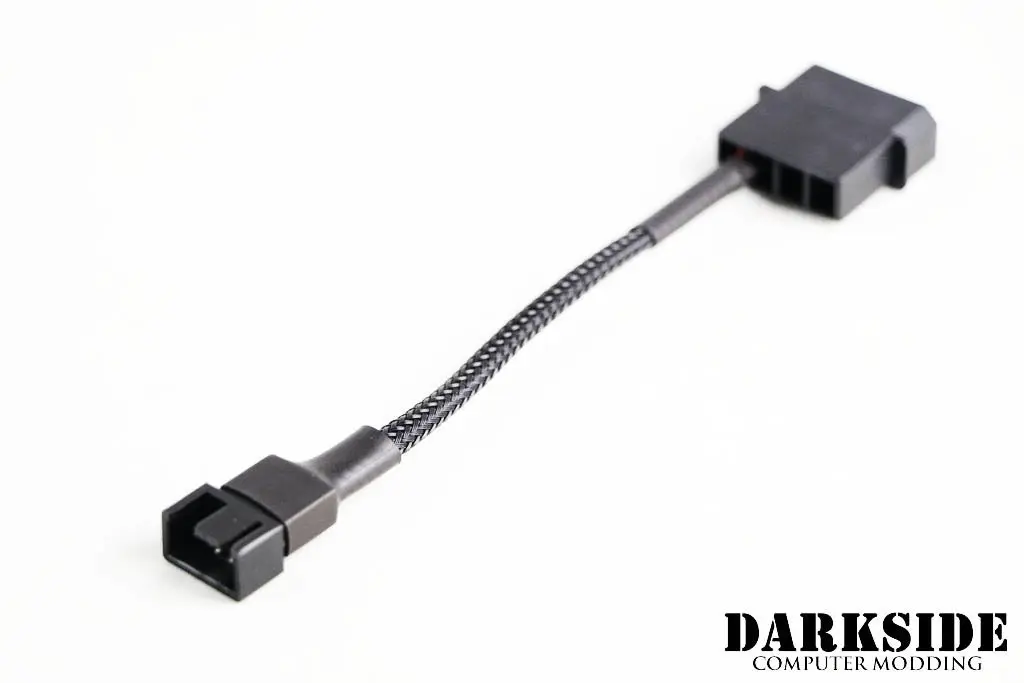

Or you can use molex to fan adapter. Pump will run at max speed then.
