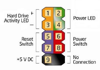

Here is a picture of the power button wire connector [link to picture], The front panel header is the standard 9 pin header.
looks like dell connector

This assumes that the mobo has the normal pins sticking out and that the connector you showed would connect to that.
Yes, if that's the pinout of your mobo, then 6 and 8 will turn your PC on, the order doesn't matter as long as both are connected, the switch just connects both pins so polarity doesn't matter.
