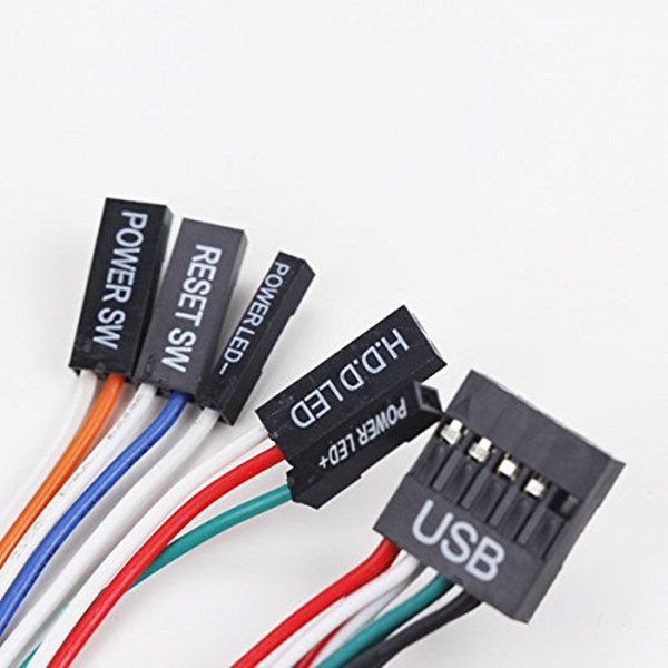

In terms of connecting the controller to the reset button, looks like the slot labelled "IBM" on the controller is where you wire your reset button to.
The connector labelled "RESET SW" will come from your front IO - at the moment it's likely wired to your motherboard directly (to perform the 'reset' function). You'd remove it from the motherboard are connect it to the "IBM" spot on the controller.
Looks like this:
Looks like this:

Now I pretty sure I did connect all of my fans to the controller box that came with the fans and for the CPU_Fan Header I have the stock ryzen 5 cpu cooler connected to that. So just to be clear I just take out the Reset SW cable from my motherboard and connect that to the IBM port on the controller, correct?

Correct. That won't be why the system is turning off, but one thing at a time.
