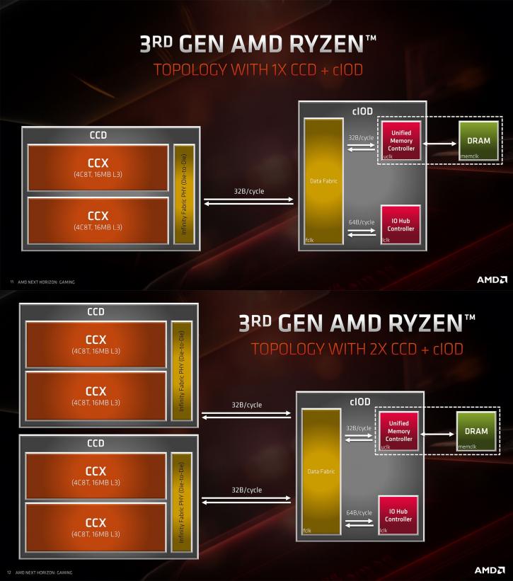

No. It's a knowledge thing. Zen wasn't an issue, if you could actually get ram speeds to 3200MHz you were doin something right. With Zen+, it was 3466MHz, Zen2 was 3733MHz, and not sure what Zen3 was. That's half the reason speeds like 3200MHz and 3600MHz were so popular and 3433/3800MHz wasn't used much, even if fclock could do those speeds, as at those speeds you lost performance and really didn't get the boost back until hitting 4200MHz.
The f/m/u clocks have to do with data transmission speeds between the i/o die and cores die. That's why fclock generally reads at ½ ram speed, it's the speed of there and back. So ram at 3600 on a Zen2 has an fclock of 1800, one way, 1:1. 3800MHz has a possible effective fclock of 950, (1900 at a 2:1 ratio). On a Zen2 cpu.
Not sure, but I believe that was one of the things that got fixed for Zen3, so may not apply. But either way, dumping higher voltages and heat through ram for gains so small they don't register on anything but a bench test doesn't do you any good.
