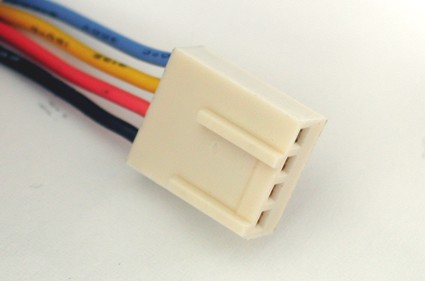

http://benchmarkreviews.com/images/reviews/cases/LEXS-001BK/nzxt_lexa_s_fan_connectors.jpg
thats how the cables look.

Well i found out every fan cable plugs in to the ones in the picture, its just 2 of them are hidden on the cable management side of the case so you dont have to connect those fans. The cable with the 4 big holes powers all the fans, and the fans that are on the front and side need to be plugged in to the cables that run to the fan controller.
Thanks alot, for telling me to find the 4 big hole cable, i figured out the rest.
