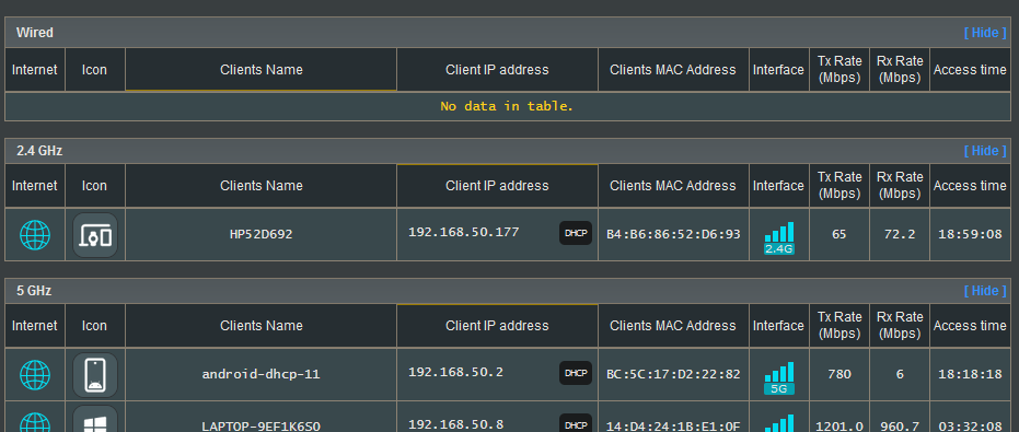

We are running an RT-AX88U Pro behind a Starlink (business) modem in bypass mode with a public IP.

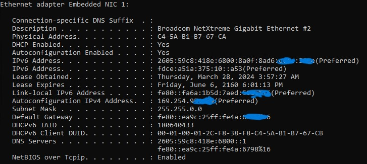

Computers that are connected via LAN - hardwired to the router or the switch - do not receive an IPv4 address - but do receive an IPv6 address.
All devices on the network (wireless, wired, etc.) can access the hardwired devices, but the ASUS router does not show any wired connections.
How would we enable IPv4 access on hardwired LAN devices? (snips below for context)
IP config for hardwired computer:
ASUS router not seeing wired connection:

The Asus should have an IPv6 option on the main page. You can then disable IPv6 completely.
You can disable IPv6 on individual devices, which will cause them to get an IPv4 IP from the Asus.

We tried disabling IPv6 on a device connected via LAN, and now it is not visible on the network.
All of his wifi devices get IPv4 addresses except wired device, however. That's weird.
Not sure if it matters, but our WIFI devices have IPv4 and no IPv6, and its the exact opposite for devices on the LAN.
Ethernet cables not plugged in properly or bad cables?
All cables are plugged in and working! Tested with different cables to be sure, but the problem persists.
