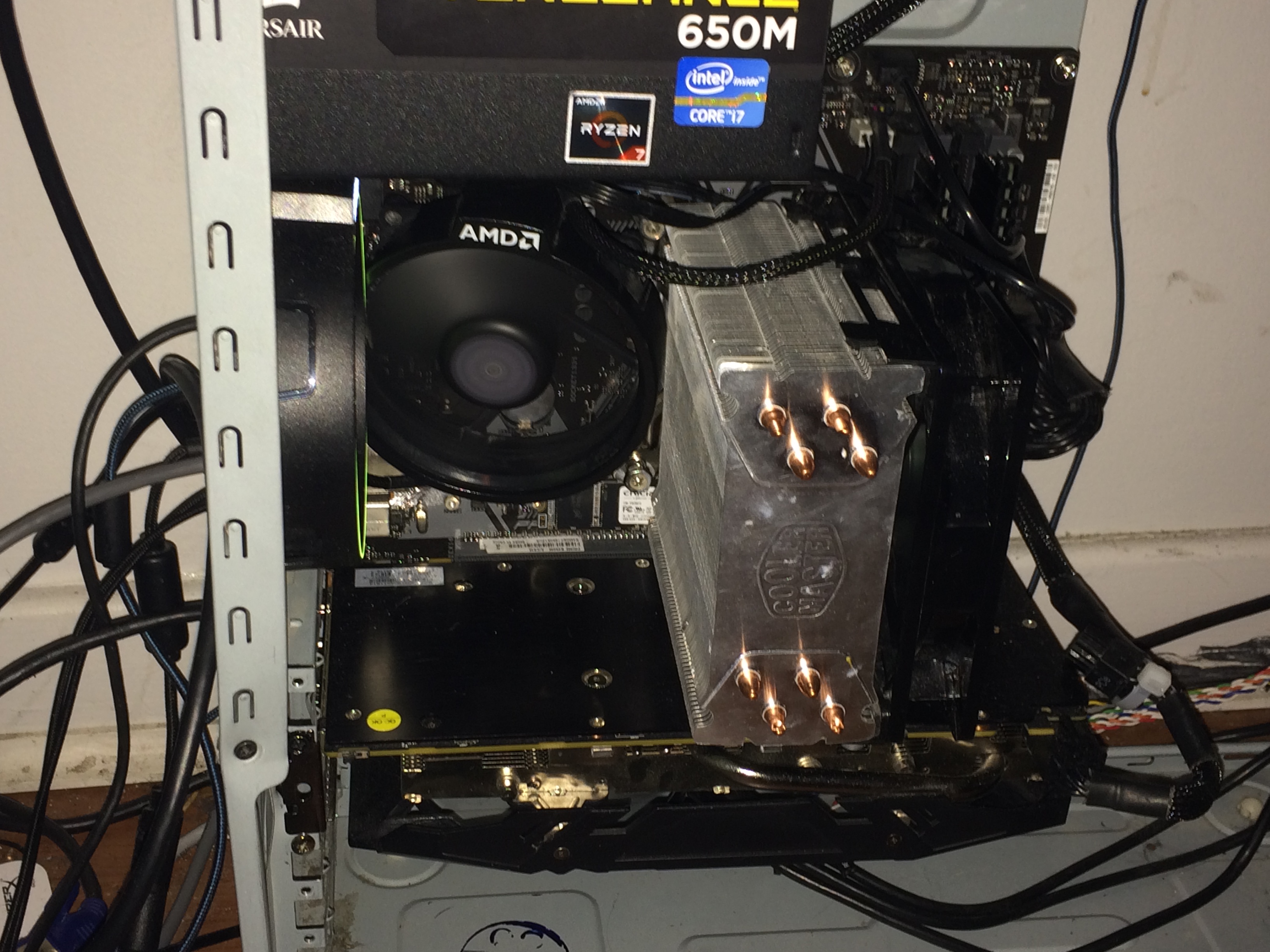

You add a fan that directs air flow onto the area.
This area:
Probably your cpu fan doesn't.
We don't know, what cpu fan you're using.
