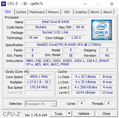

-just to give reference on what i have on my rig: 4.6ghz with 1.272v. (also a non-k)

i just looked at the screen shots from ur hwmonitor... i swear that looks like 1.7volts on ur vcore..

I suppose that you refer to my i5 6600K Intel CPU VCore set manually to 1.355 V in the BIOS. It is really not much at all. You can't have "4.6ghz with 1.272v. (also a non-k)" on your rig - it doesn't make any sense even though your rig seems to be an (irrelevant) 6400:
1) A "non-k" i5 6600 Intel CPU (assuming this is what we are writing about going by the thread title) runs at 3.3 GHz (https://www.ple.com.au/Products/620470/Intel-Core-i5-6600-Skylake-33GHz-6MB-Retail-Box). It is 2.7 GHz for an i5 6400. That's precisely why we buy a more expensive "K" version, to go over the stock-standard 3.3 GHz via overclocking... duh.
2) "i swear that looks like 1.7volts on ur vcore" seems to indicate that you are not looking at the CPU VCore voltage when you mention 1.272 V. My CPUID HWMonitor shows (I am still looking at it while writing this) under "Voltages" (first line of figures at the very top) CPU VCORE 1.356 V (Value) - 1.344 V (Min) - 1.356 V (Max) - in fact, "1.7volts" as you write would probably blow up the chip (even in liquid nitrogen) as Intel stipulates an absolute maximum of 1.52 V - ...just saying
