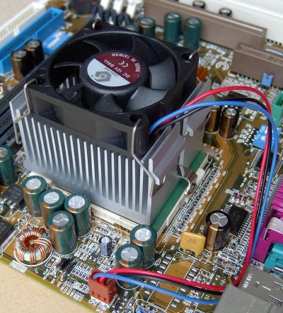

1. The Memory Card attaches to the USB Headers {see image}
2. The BIOS controls the CPU Fan {if the CPU fan is connected to the CPU_FAN header; normally it is located in the upper-right corner <or> one of the corners of the CPU}. If you boot into BIOS, boot and tap the DEL key, and arrow to the right, Load Defaults, Save and Exit. The CPU fan will be controlled according to temperature.
All of the above is fairly universal to all MOBOs.
Good Luck!

There is only One USB 2 and one USB 1 on the mother board is not even close to the picture you provided me earlier for USBs
The USB2 has two rows of pins. The upper raw with five pins and immediately inderneath a 4pin raw. Both raws are used for the 2 Front USBs therefore there is no place to plug the internal SD flash reader. You think if I connected to USB 1 would do the job?? I haven't tried it.
