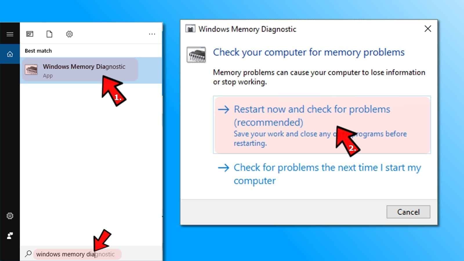

Windows Memory Diagnostics may find RAM problems and troubleshoot Kernel Security Check Failure.
Open Windows Memory Diagnostic.
Click Restart Now and check for problems
After restart check test results. If they do not appear automatically, right-click the Windows icon and open the Event Viewer.
Windows Logs> System. right, click Search and type memorydiagnostic. Click on the appropriate event to see more details.
