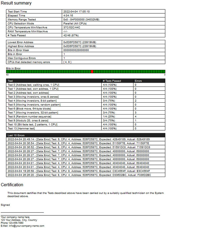

Hello Members
For a while I seem to have an unstable OS and at random irregularities, nothing major.
Remembering some years ago I did a memtest and so I tried with the free Passmark MemTest865. See here below.
Has anyone a suggestion other than replacing the RAM units(s)?
Thanks

Please verify this is your motherboard here.
If so and if the RAM modules' part number is indeed CMK32GX4M2B3200C16 are actually in the RAM QVL list by the manufacturer(Asus) here page 22.
The correst slots for two sticks of RAM are slots A2 and B2. The lighter grey ones. Slots 2 and 4 counting from CPU socket. Like image below, taken from page 1-5 of manual here.
As said above, if they are in the correct slots any error in memtest86 would mean RAM is bad and should be replaced.

Is the RAM installed in correct slots?
thanks @drivinfast247
The RAM has been installed approx two years ago, assuming I had installed according a manual.
any error count higher than 0 is too many on memtest
so if its not in wrong slots, ideal solution is rma ram and get new stick. I don't have any other ideas
thanks @Colif
As I said above, it's been there for at least a year. Is there a way of checking if in the right slots?
Is your Ram overclocked XMP/manual tuned?
Thanks @IBeats
No overclocking or tuning done

Says slots 1&2 that could(more than likely) be incorrect. What motherboard?
Thanks @Satan-IR
Very detailed input of yours and very much appreciated!
Yes to all of your points above. So it does not leave many options for me😞
I did read on the Corsair website about Memtest and RAM faults. Also I mentioned above that I haven't changed anything from original settings by the supplier of this PC.
Would you have much hope on their suggestions?

No problem. If you mean the RMA process I think any error in memtest86 should be proof enough RAM is bad.

Update:
After emailing the RAM test errors to the PC supplier they agreed to replace the RAM . Very generous of them as I bought this machine early 2019.
