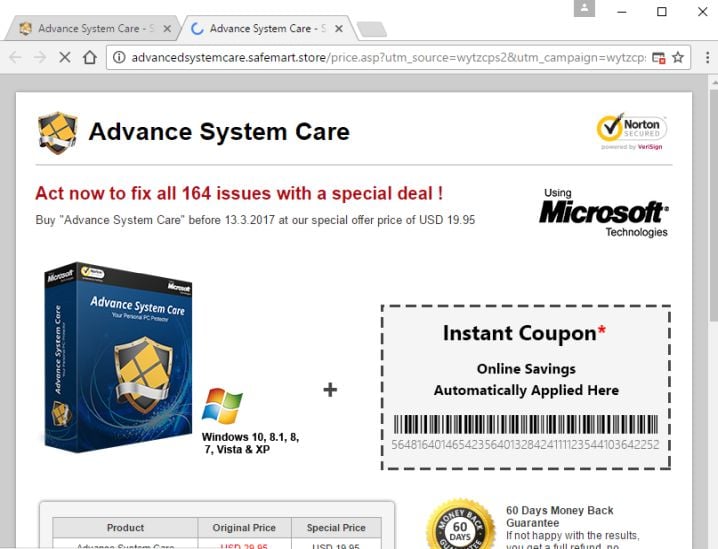

That "Advanced SystemCare" is almost certainly the issue.
It is snake oil at best.
Uninstall it, and see what happens.
THIS.
Most IT sysadmins consider it a virus. It causes slowdowns and servers up extra advertisements instead of actually helping.
