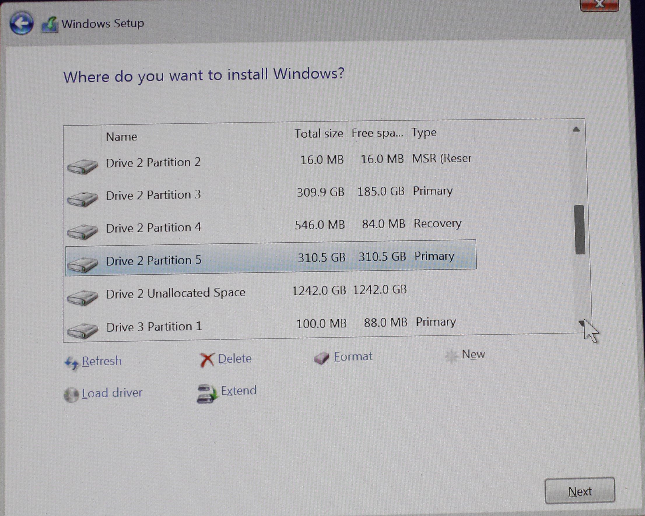

I have here a photo of the win10 bluray installer options:
http://www.directemails.info/tom/win10/win_install_drive.jpg
just by looking at that, I can tell you what is going on:
the 309.9GB is the first scratch install of win10, as its not the full 310.5GB, as there are 2 administrative partitions on either side, automatically generated by the earlier install. the highlighted partition is thus the scratch install of win11, eg the entire 310.5GB disk free.

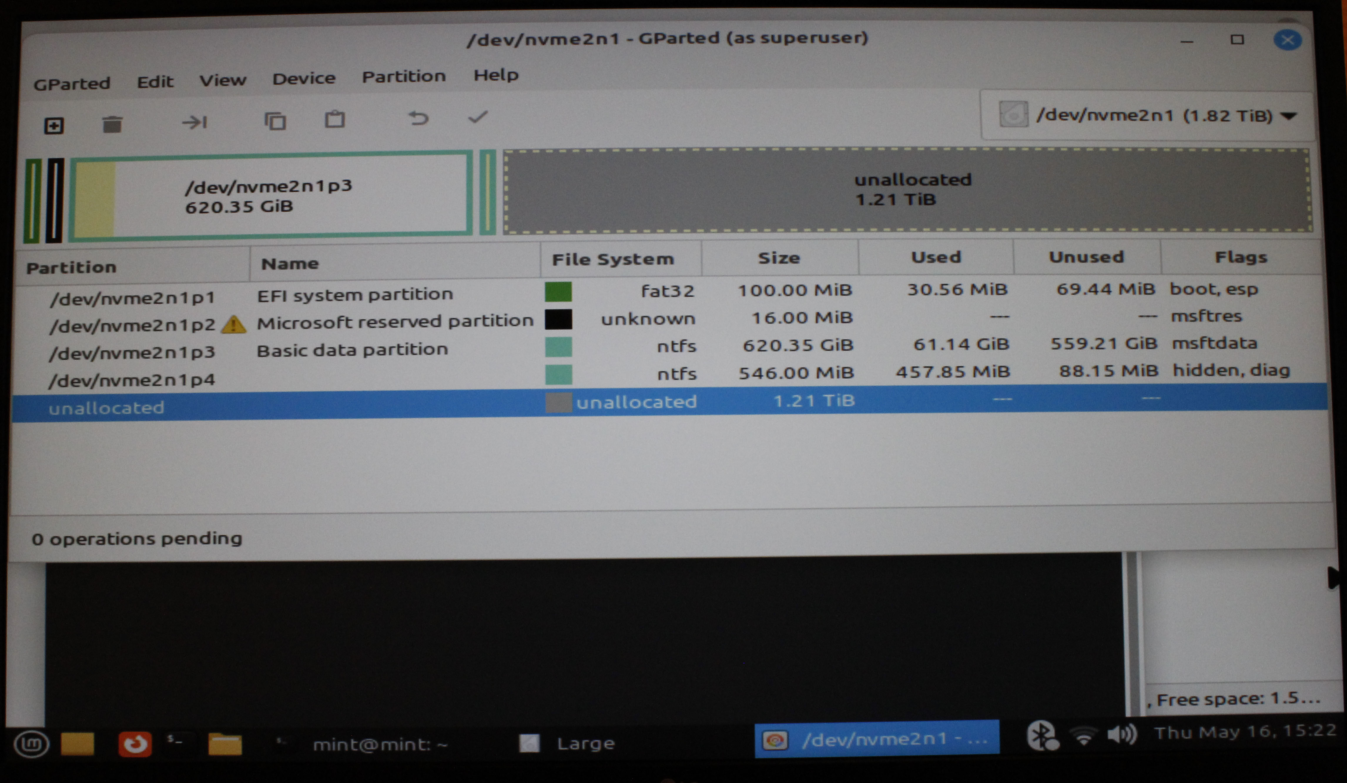

here is a photo of the Linux GParted program:
http://www.directemails.info/tom/win10/Linux_Mint_GParted.jpg
just by looking at that I can tell what is going on, the 620.35GB being a bit less than the intended 621 means that is the main win10 install, and I havent yet installed the main win11 install yet, and would be moving towards that.

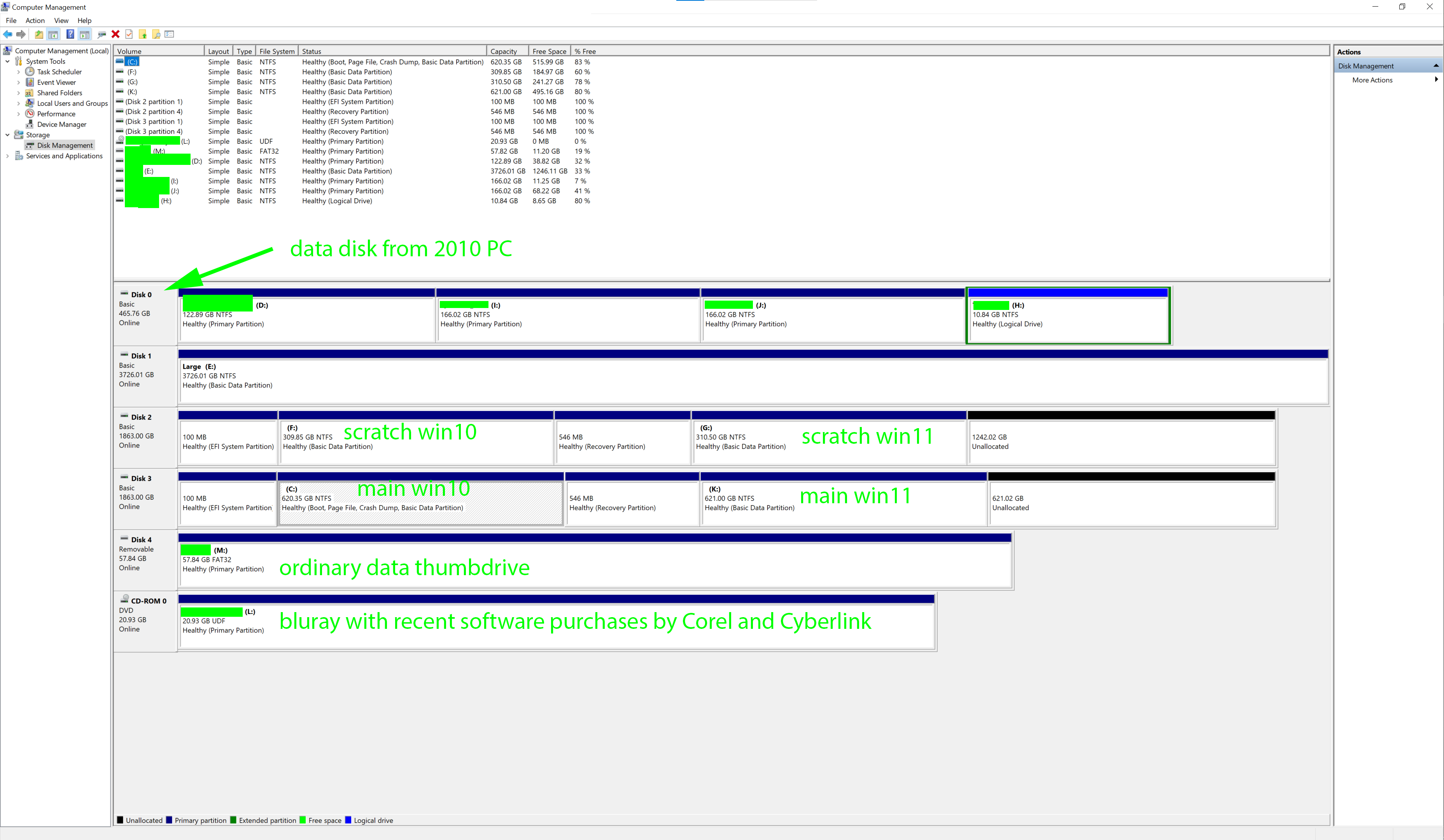

with my MO, the first thing you need to do is a "site survey" of all attached disks. to discern an aeriel view as to what each is. by which on the Windows side I mean this view, which is well hidden to on Windows:
http://www.directemails.info/tom/win10/2024_05_18_0256_disk_overview.png

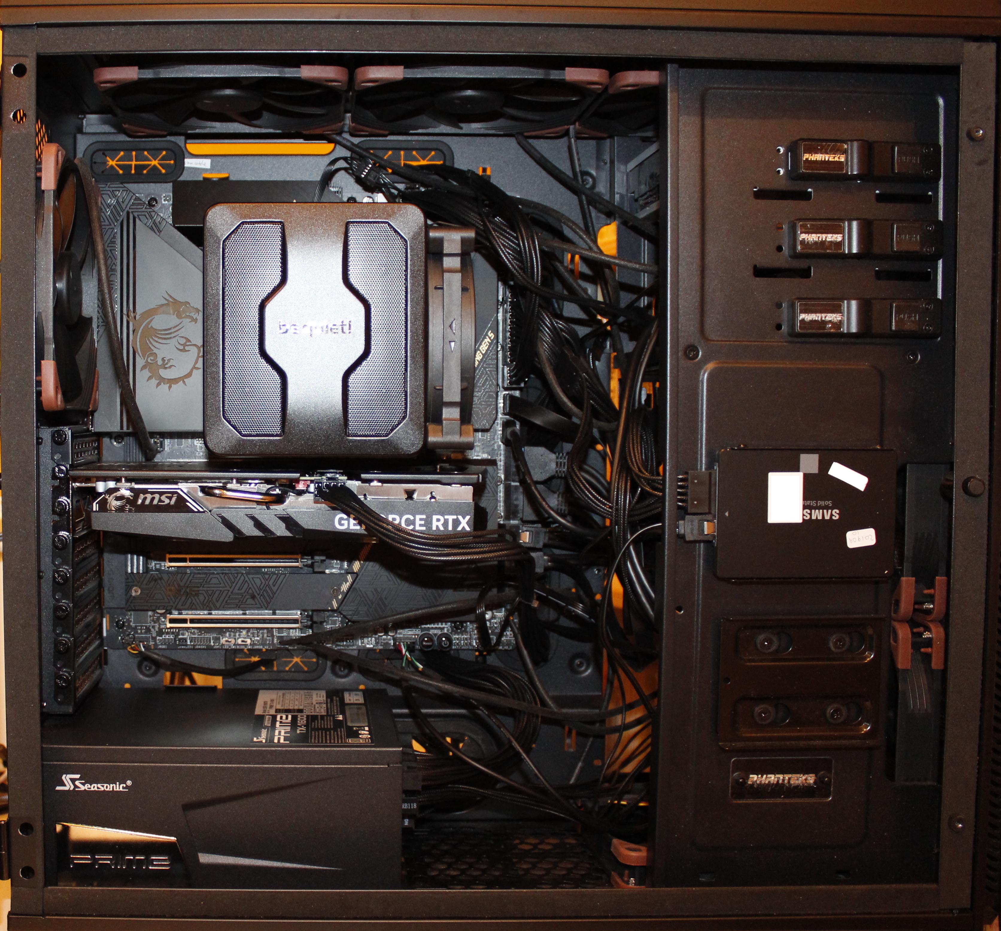

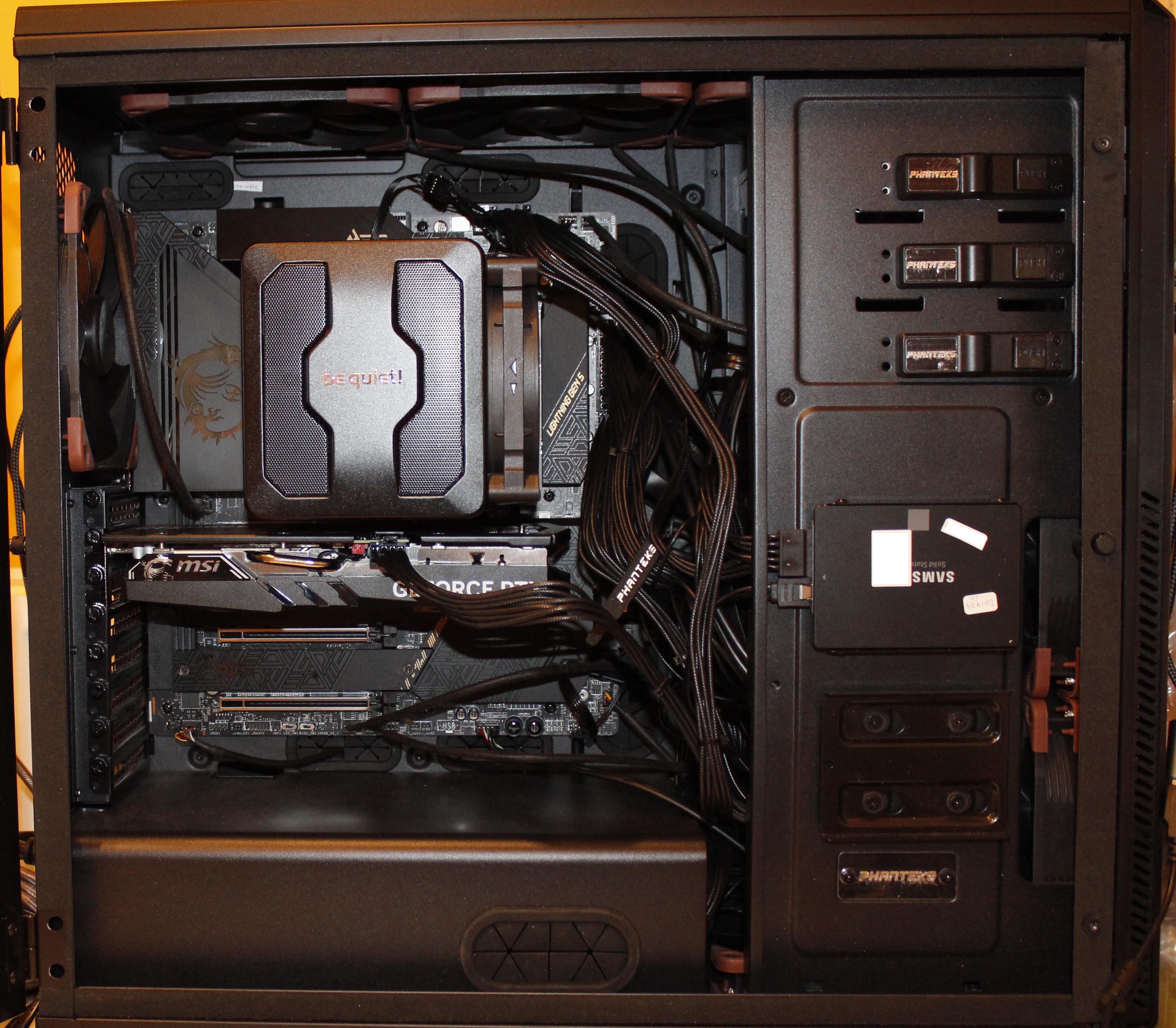

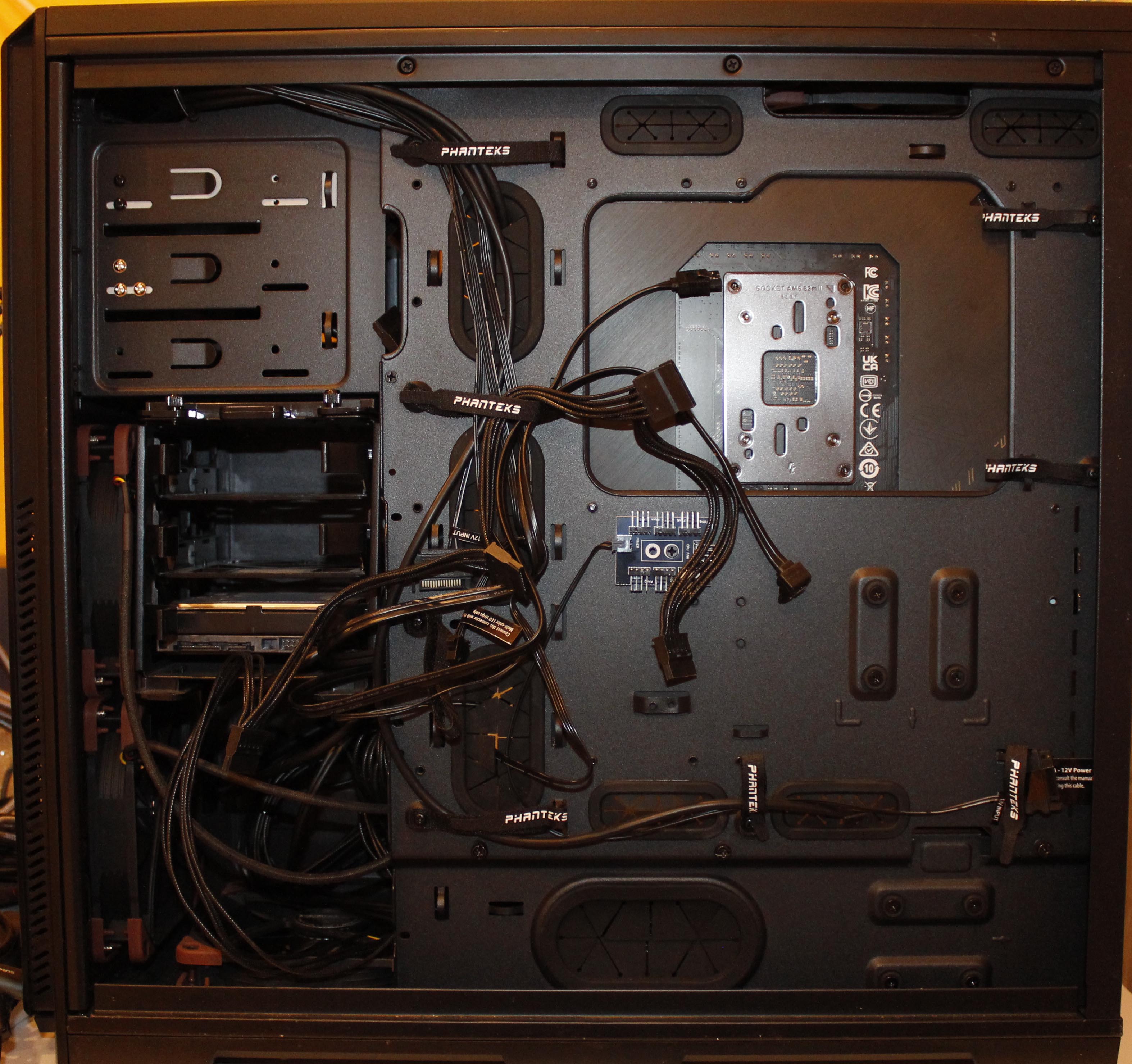

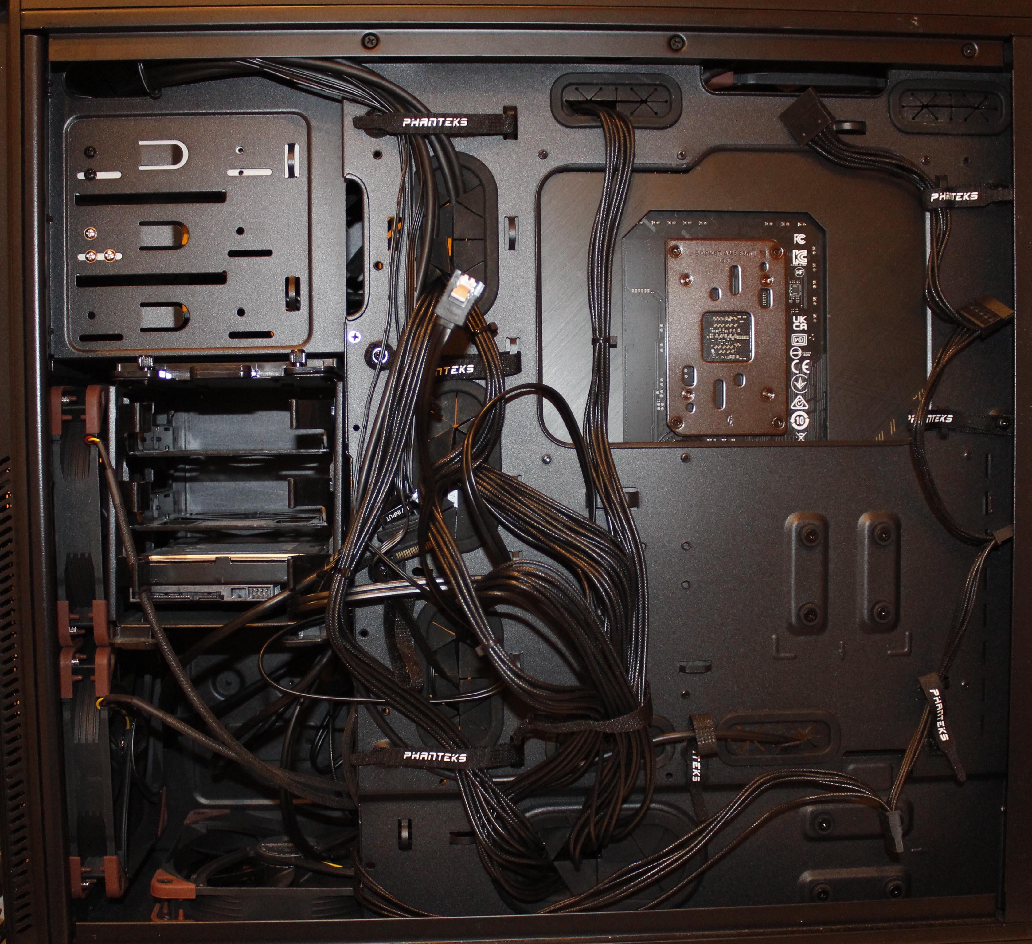

One of the reasons why i suggested full-tower ATX was to give you more space regarding cable management. Behind MoBo tray, there is enough space to route the cables. And if PSU shroud gets into way, remove it completely. After all, PSU shroud is just for eyecandy. It serves no practical purpose.
I thought maybe the L shaped PSU cover plate was to shield from heat, but you think its entirely eye candy?
its a bit of a nuisance to remove to attach further PSU cables, as it has 3 thumbscrews on the opposite side to the door, ie you have to remove the side panel, then remove 3 thumbscrews, then precariously remove the plate as you have to dodge obstructions. and then later the reverse process of all this.
I will try your suggestions as regards cable decluttering, and also will try to take some photos.
the PC is quite heavy, and I may have to detach various cables to photograph it properly from several angles, but I will try to do this later.
one problem is when I take photos, its not the same as seeing the actual machine, things which are obvious with the actual machine, are non obvious in a photo, now this is partly a matter of photographic skill,
In airflow aspect it actually makes it worse, separating bottom part of the PC case from the rest. And it's main purpose is to hide the PSU and cables coming from PSU. So, you can freely remove it.
I, personally, don't like PSU shroud, hence why i don't have them. Only my AMD build has it, but it can't be removed. Then again, that Sharkoon PC case is one of the very few ones with green interior, which i needed for build theme.
Initially, PSU shrouds were regarded as DIY projects, with several enthusiasts crafting unique concealments by utilizing a wide variety of materials. Some builders fashioned custom shrouds from fiberglass, plexiglass, or even aluminum, whereas others resorted to 3D printing for designing colored polymer covers.
Consequently, manufacturers recognized this emerging trend and included PSU shrouds in almost every PC case that shipped with a transparent side panel. Nowadays, you no longer need to rely on DIY solutions as budget PC cases often arrive with built-in shrouds, elevating the visual appeal of your custom build.

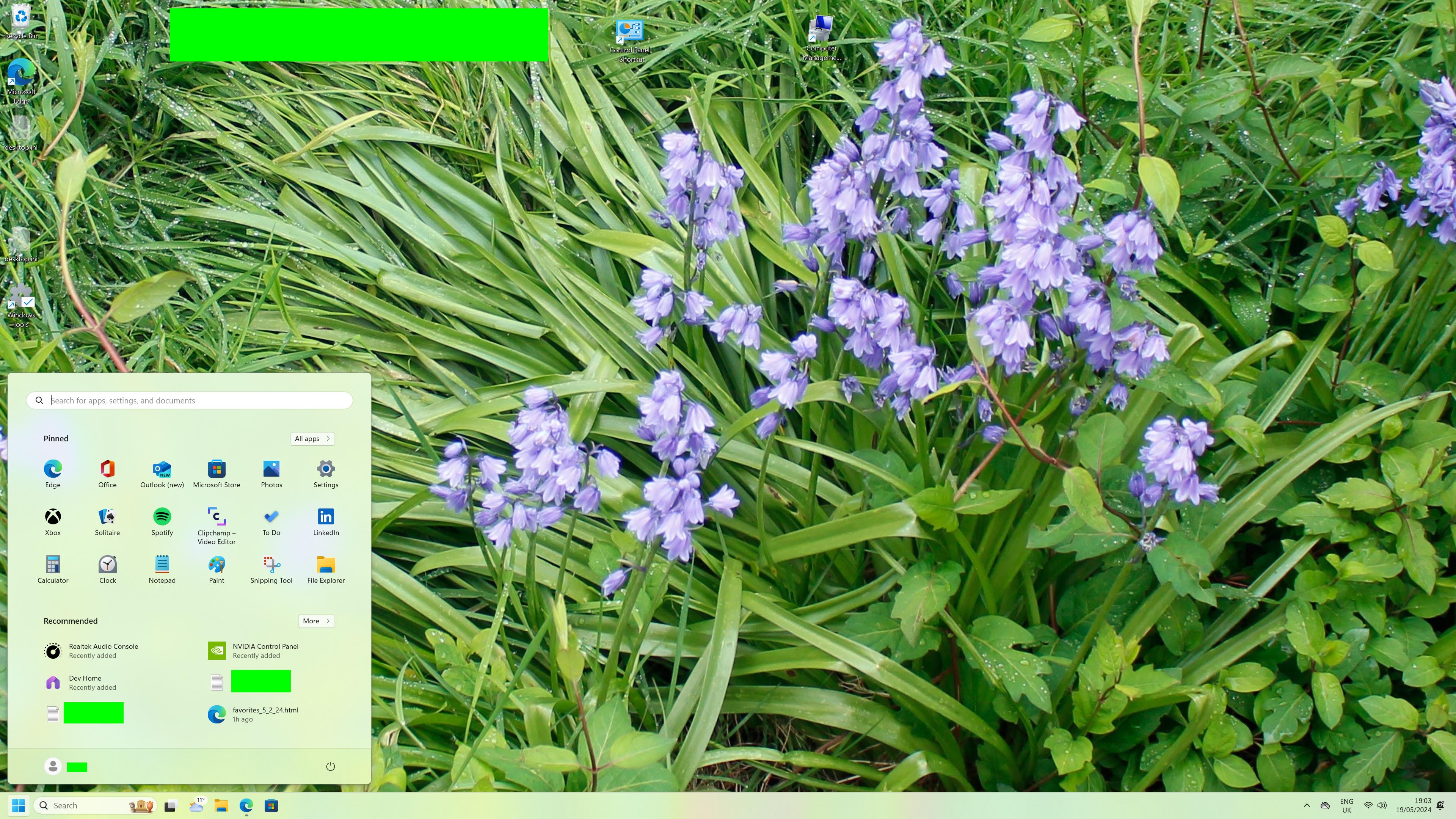

and I then reset default OS to win10 again, just in case. and I am writing this from the successful reinstall of win11, also the upgraded win11 is superb, with subtle colour tinting eg this screenshot, where the photo is one I took myself, where those flowers are bluebells. it is possibly doing chamaeleon tinting, that the photo has a green colour theme, and thus subtle green tinting:
http://www.directemails.info/tom/win11/tinted.jpg
where I have redacted some info!
if I run notepad that also has the tinting in the header.

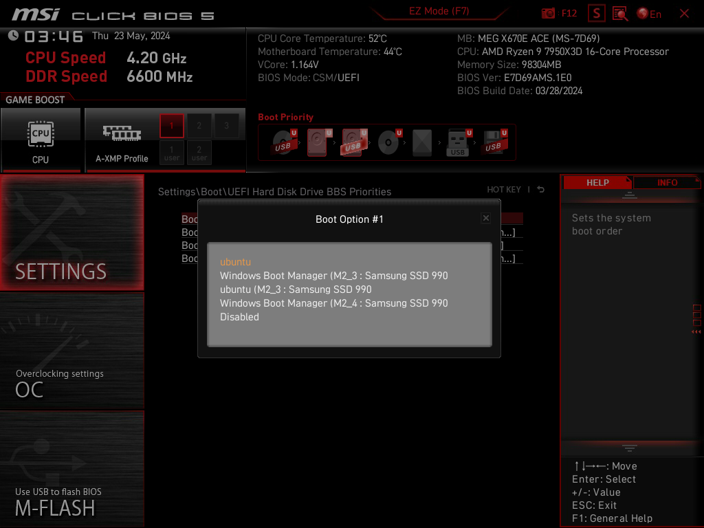

and then to reboot, set the UEFI to boot from that bootloader, and hey presto, a selection of all 4 OSes from the scratch bootloader! so I can do anything now! and of course the win11 one froze up, ie the problem wasnt the bootloader, but the legacy software had trashed something, but the 3rd installation attempt fixed the problem by upgrading in the same session, which was a really lengthy session of many hours.
and now everything is booting fine from the scratch bootloader, I havent rejigged the other bootloader, but will probably also supply all 4.
ok, its gonna get ripped out and mothballed permanently! its a right nuisance!
Source: https://www.makeuseof.com/what-is-a-psu-shroud/
I will remove it as soon as I have some of these other problems progressed

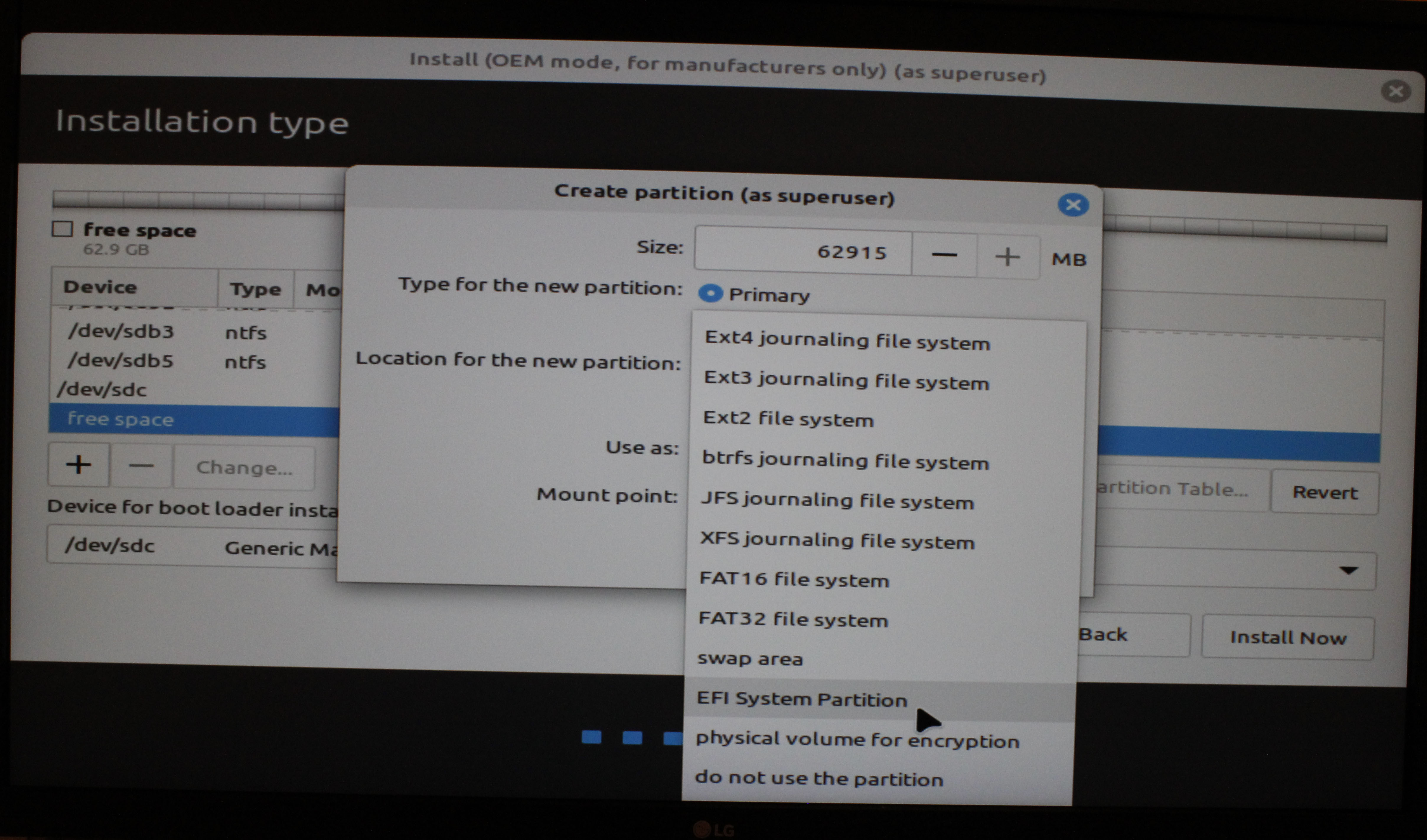

progress report: the MO for Linux is working, where I forced Linux to supply a new bootloader on the same disk, and now in the UEFI there are 2 ubuntu loaders:
http://www.directemails.info/tom/linux/double_ubuntu_2024_05_23_0445.png
where I installed Linux Mint cinammon Edge to a flash drive, with its own bootloader, and no reference to any OS on any other disk. afterwards I tested, and Linux mint cinammon edge boots fine from the flashdrive, so I can use that if the system malfunctions.
the MO is to make any disk with bootloaders appear as if unallocated,
then to install Linux to a genuinely unallocated disk, and you have to firstly create an EFI system partition on the Linux install, which is a really obscure option:
http://www.directemails.info/tom/linux/efi_system_partition_option.jpg
I set that at some 100MB, to mimic what windows does.
the way I make all pre-existing bootloaders vanish is to basically backup the first 1024000 bytes of any disk which has a bootloader, and even did that with the data disk 4T M.2 drive,
this is the disk rather than a partition, the same MO could be used on a partition instead, where the partition would become unrecognisable to the system,
then I make a file of the same 1024000 size just filled with repeat characters,
and copy that to the first 1024000 bytes of the disk,
and hey presto, the partition manager shows that disk as unallocated.
also on rebooting, the UEFI has no bootloaders at all.
this requires careful notes,
then with the Linux install, you have the installer forced into a corner, and it has no option but to
do everything from the target disk.
afterwards, I checked all the other disks and they all remained apparently unallocated,
reinstated the backed up 1024000 bytes, and hey presto, the disks now all instantly populated with their original partitions,
and on rebooting, the earlier screenshot is of the various bootloaders which now all reappear including the new one for the flashdrive at the top, which just says ubuntu without any other text.
and I have now booted to the main win10 install to post this message.
on the desktop, the disks now are fully populated again with their directories and files.

I did run into one snag when reinstating the 1024000 bytes, which is that the two 2T M.2 drives are identical.
I checked all my notes, and all concurred that Linux enumerates them as nvme0n1 is M2_2, nvme1n1 is M2_3, and nvme2n1 is M2_4, ie in numerical order, and its all functioning after that.
because of this unforeseen snag, I will modify the MO to use different repeat symbols per drive, where you need to verify you have the right repeat symbol where you dont have to rely on the drive enumeration order by Linux.
the programs in fact allow a choice of repeat hex symbol, but I will modify that a bit to give an ascii repeat symbol instead. I was using hex 41 which is 'A' as the repeat symbol.
backing up and replacing or reinstating the first 1024000 bytes is virtually instant, but you need to check and double check that you havent made any errors, and that you select the disk rather than a partition on the disk. you could work via a partition also, I cut and paste the shell history to a file just in case.
for accessing the disk bytes you need the sudo prefix, eg
sudo ./someprogram arg1 arg2 .....
anyway, this MO enables one to force Windows or Linux to install a bootloader on the same disk if its a new disk, or to unify to the existing bootloader on the same disk, without having to remove any disks, but you do need to do a survey of the disks to determine which ones have bootloaders, and to make these vanish temporarily using the MO.
ok, I have finally removed it and it is "mothballed".
I dont know if people today use the word mothballed in the literal sense, but when I was a kid, people would stash things such as coats in wardrobes, and moths would start eating the clothes. People would put mothballs to deter the moths, these were white spheres maybe 13mm diameter, which you'd put in the wardrobe. the last time I saw a mothball was around 1977.
as everyone did that, the word acquired a metaphorical meaning, of when you no longer use something and preserve it in storage for the foreseeable future.
in the modern era, the clothing tends to be made of materials which dont attract moths, and people nowadays junk things they no longer use. in those days people would keep everything forever, even if things stopped functioning, this was viable as much less stuff.
anyway, I have been battling with decluttering the cables, and I have sent various ones round the other side of the mobo, in particular the 2 to the top edge of the mobo, by top I mean relative to how it is when the tower case is in use. then 2 to the right edge of the mobo, including the one with a ton of pins, and next to it a smaller one 3x2, there was a removed 1x2 which is with that bundle of cables and not attached anywhere.
that one with a ton of pins, I had to detach one of those double USB sockets, as it obstructed the grommet,
I also rerouted the PCIe cable to the graphics card, I think that is probably all, which is 5 cables, this has improved a lot the aeriel view of the mobo. but the other side of the mobo is now more cluttered, and I finally removed and mothballed the fan hub at the back.
at one point a grommet started becoming detached!
with each I made sure there was a distinct clicking sound when I reattached the cable, and for a few I detached the cable at the PSU side to disentangle from all the other cables.
reattaching cables was a bit problematic, I had to use torches to try and align the plugs, and there was a bit of guesswork. I did check the shapes of the pins!
I also removed and mothballed the PSU shroud: big improvement! its now nicer than a PC with the PSU at the top.
although its just a few cables, it was very strenuous and time consuming to do.
when I put it all back together again, and powered up the PC, this really noisy rattling sound, so I powered down the machine and did a visual, it was the power cables for the front fans running along the base fan, so I rejigged that and now its all alright.
here are some photos:
before the decluttering, the aeriel view of the mobo in the tower, with the PSU shroud in place:
http://www.directemails.info/tom/tower/before1.jpg
note the SSD which isnt in the photo Aeacus gave of the Phantek Enthoo Pro, so this must be a later revision of the product.
the other side looks like this:
http://www.directemails.info/tom/tower/before2.jpg
where the fan hub in the middle vanishes in a later photo
note on the right hand side a bit below the middle, there is an arrangement for a 3rd 2.5" SSD, but they only supply 2 caddies. you can relocate one of those 2 to that alternative area. I dont know if Phantek sell spare caddies.
after the decluttering, the aeriel view:
http://www.directemails.info/tom/tower/after1.jpg
and the view of the other side:
http://www.directemails.info/tom/tower/after2.jpg
with the fan hub removed.
I removed also one of the 2 SATA WD Blue drives, one remains in the latter photo, and have rehoused the other one in a USB3 enclosure which I bought I think on Friday.

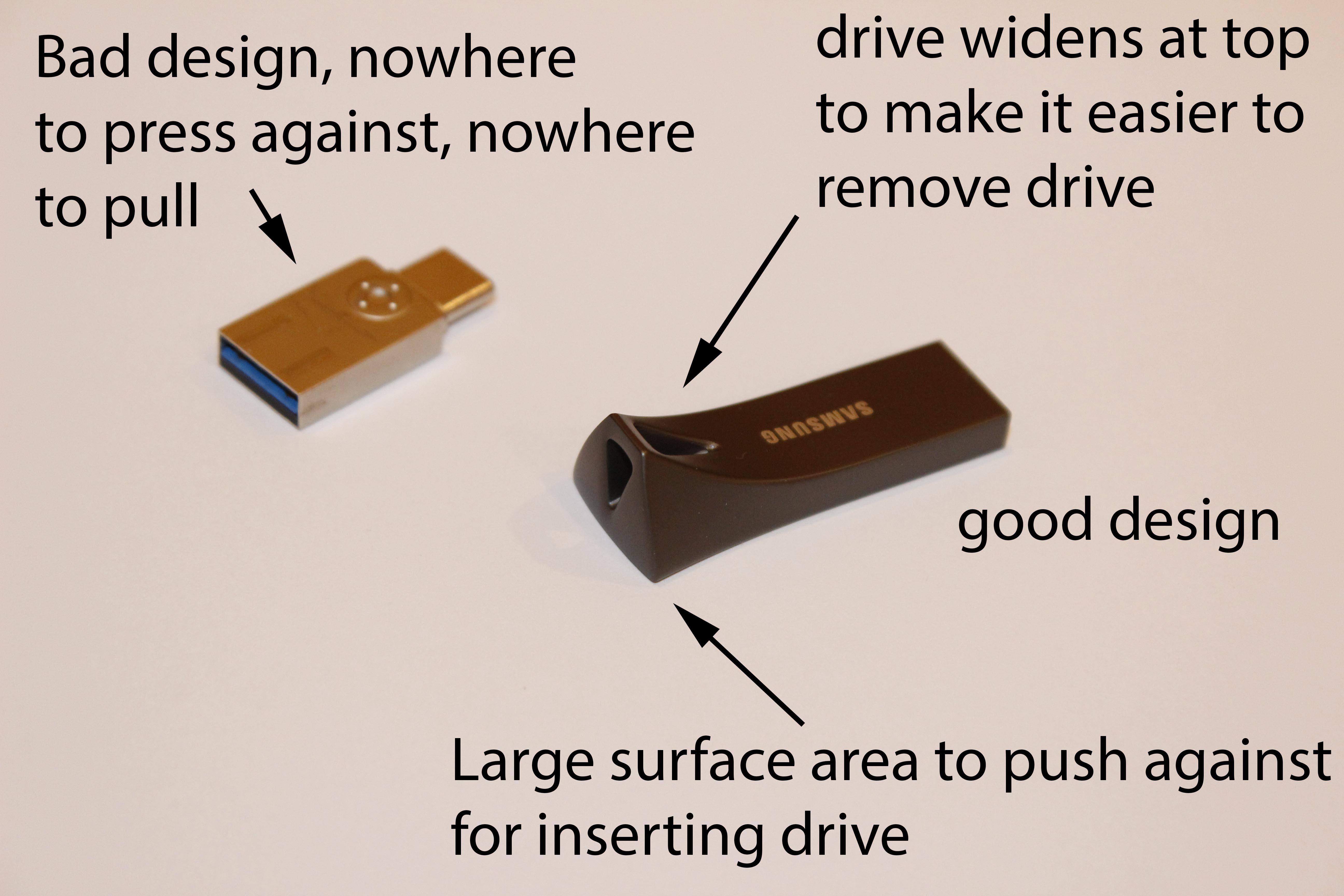

I have now bought a vastly superior flash drive by Samsung, here is an annotated photo of the 2 drives:
http://www.directemails.info/tom/drives/flash_drives.jpg
on the upper left is the rubbish drive from a supermarket, cost some £15,
the problem is it requires some force to insert, and there is minimal surface to press against, and its worse to remove, because if in a zone with a lot of USB cables attached to neighbouring sockets, its difficult to get a grip on the item without pushing the nearby cables.
the lower right is the Samsung one, where for inserting, it has a broad flat surface to easily push against with your thumb, and for removing, it widens so you can get a good grip. this one in the photo is 256Gig, and cost £34.99, whereas the supermarket one is some 58Gig and cost some £15. bad quality and bad value for money and possibly defective.
I also bought a Toshiba 2T drive, for some £70. I scrutinised the different manufacturers and prices and capacities. going from 1T to 2T seemed a nice improvement of value, but 2T to 4T looked dubious, so decided to go for 2T. they told me they have Samsung external SSDs behind the counter. these cost I think more than double for 2T, and on enquiring about size are half the size, and a lot faster. but I decided I only need a few drives which are higher end for when travelling, this one can be low end, I think it was the cheapest USB SSD 2T in the shop. I have a 2T miniature Samsung already from 2023, called a T7, and I might shunt the data to this cheaper one, and use that one.
For one, your PC now looks far better, with good cable management done. (y)
Also, i can see from the pics, that you now have easier access to the ports on MoBo, both from the front and also easier access to 3.5" HDDs from the back, since cables are moved aside, behind MoBo tray, where they are supposed to be (away from everything else). Also, airflow is now better as well. No more blocking of front/bottom intake fans and CPU cooler also has more free air to pull in.
So, overall, while it took long time, are you pleased with the result? :)
And i too think that PC looks much better without PSU shroud. Nice to see the Seasonic PRIME in there. :cheese:
Oh, if you already didn't know, there are brackets out there where you can convert the 5.25" bay to hold either 1x 3.5" HDD or 2x 2.5" SSDs. So, when you need to add more drives and ran out of the 3.5" HDD cages (since after all, 6x slots total in them), you can chuck some into 5.25" bay.
Phanteks does list the 2.5" SSD bracket on their website as well. Phanteks PH-SDBKT,
specs: https://phanteks.com/PH-SDBKT.html
So, you would need two of those, if you want to mount 2.5" SSDs at the back of the MoBo tray.
Did find it on sale on amazon, link: https://www.amazon.com/Phanteks-Bracket-Single-Enthoo-PH-SDBKT_01/dp/B00M0R6IFW
There are two sizes of it. One that holds one 2.5" SSD and another one that holds two 2.5" SSDs. Now, i don't know, height wise, if you can fit the SSD bracket that holds two 2.5" SSDs. You need to measure it. E.g stack two 2.5" SSDs ontop of each other and look if you have enough space to close the side panels.
ok, I hadnt thought about the airflow aspect, removing the shroud also should majorly improve the flow from the base of the tower.
one cable I didnt reroute is the SATA power cables, as I have SATA on both sides of the mobo, namely the 2 SDD cages at the door side of the tower, and then the 3.5" cages, also the optical drive, although after getting the external optical drive I disconnected the internal optical drive. it is installed but disconnected:
I think optical drives burden the booting of a machine, so it is best to only have them connected when you actually use them, and also to make them last longer. unused optical drives also waste drive letters, which for me is a problem as I often have used up all 26 letters, and have to swap letters to access all partitions!
right now I have 11 letters used up, one of which is the optical drive. D, I, J, H are the partitions of the SSD in those photos, the 4T is E, the scratch installs of Windows 10 and 11 are F and G,
the main installs are C and K, the main flashdrive is M and the optical drive is L.
this is where I think external USB3 optical drives are better, AND you can reconnect the same one to different machines. I only sometimes use optical drives, namely:
1. windows and Linux installers, via BDRs as these are much faster than DVDs. win11 wont fit on a normal DVD but possibly fits on a double layer one.
2. for long term archiving of less used stuff,
eg sometimes if I do a major new journey with the car, I save the dashcam footage of the entire journey for future reference. eg I visited a place near Birmingham, where the first journey was through the countryside, but 2nd journey was through Birmingham and I got fined something like 60 for driving my diesel car in the clean air zone there and not paying as I was waiting for them to send me a bill the way London does! so with dashcam footage I can study how to avoid driving into the city, the footage gives North South East West coordinates for each video frame. blurays are the best way to store this kind of stuff.
another example: the satnav once sent me on this really scenic journey from one part of Bristol to another. some years later I wanted to do the journey again, but all I could remember was the start and end point. so I drove to the start point, and put the end point in the satnav, but this time a totally different uninteresting journey! that earlier one was because of roadwork diversions! luckily I had saved the dashcam footage, and from a few hours of study of the video compass coordinates and Google Earth I repeated the journey from memory of the Google Earth views!
3. for purchased installs, eg I nearly fully filled a bluray with the installs for the Cyberlink and Corel Roxio bluray burning software and further software. because the purchased downloads are to internal drives.
yes, its definitely better!
I hadnt done it originally not because of laziness but I wasnt aware of the idea!
I thought the grommets might be for liquid cooling of the machine!
:cheese:
that shroud also makes the already heavy PC even heavier, I weighed the shroud just now and it is 507 grams, and removing and reattaching slows down accessing the cables, reattaching in particular is tricky as you have to raise the shroud a bit to align the 3 thumbscrews.
the shroud also obstructs airflow!
can you give any purchase links for future reference?
measuring, the plane the cage is to be at is 2.5cm from the lid cover, and the attachment is maybe 0.5cm elevated, the purchase URL for the double decker one says 2.54cm, but that probably includes the ridge going in the other direction, and the tower lid cover is flexible so can bulge a bit, so I think it will fit.
the 2 bays at the front are on a plane with 3.5cm leeway, so that means one could have 6 SSDs in total!
but the catch is you would use up all the SATA sockets! unless there is a way to buy further SATA sockets?

Windows and Linux wont modify a user created partition unless you select an option such as "this install will erase earlier stuff", but they will modify automatically generated system partitions, eg with the 2 scratch installs, I designated exactly 310.5GB for each, but the first one in fact got 309.85GB, and the deficit was used to create some system partitions, Windows and Linux might modify those unpredictably. you can stop this by obliterating an initial segment of these partitions. but I have only tested this on the EFI system partition.
the 2nd install got exactly 310.5GB as requested.
afterwards to reinstate the bytes from the backup.
