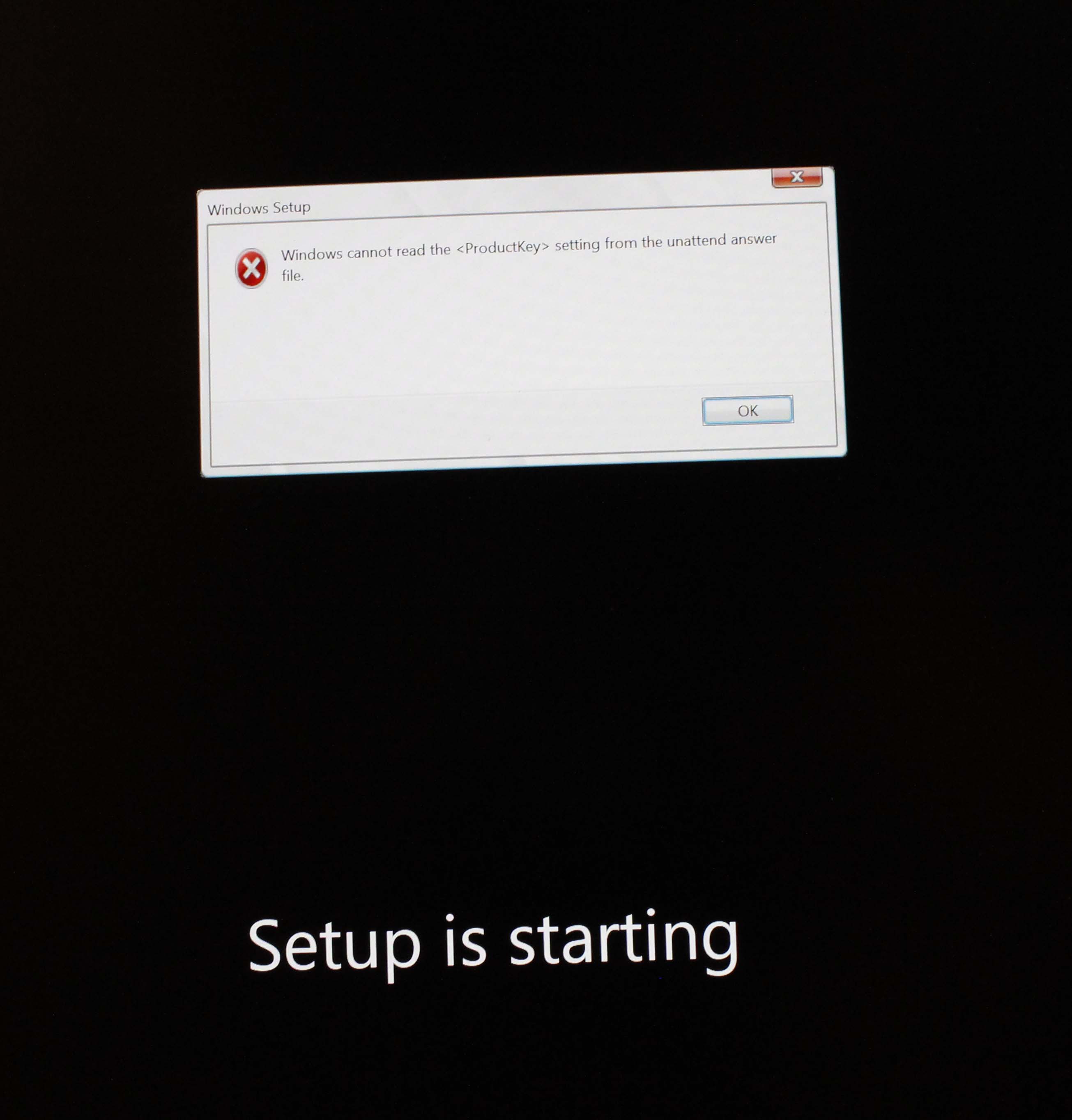

progress update, I ran into problems with the 2nd Windows 11 install, its just an experiment so I could just reformat it. but I decided to try and fix it in order to learn how to deal with this.
where that Windows 11 wouldnt boot at all. but the other Windows versions would boot. but I had to go via the Linux boot to reach them as that 11 was the default boot and was bricked up!
after a lot of failed experiments, I got Windows 11 to boot, via booting with the Windows 11 boot bluray, and selecting R for repair at the start, eventually reaching "startup repair", which then allows me to select any Windows install. now the identical looking options from when you boot to Windows, where it shows the various Windows versions, and then another option which you then click, and navigate from there, that
only allows you to repair the current default version, so is no use. it skips a step which the installation bluray gives when you click R for repair. they should have a V option also for vendetta!
now after this, Windows 11 did boot, but I then found that Notepad no longer worked!
to deal with that, I had to run Setup.exe from the Windows 11 bluray, from the problem Windows 11 desktop, and then select an option that preserves data and programs. that took hours to complete, I could tell it hadnt frozen up by looking at properties for C:\ where I could see the bytesize was continually growing. eg at one point it was stuck at 46% for ages, but the bytesize was continually increasing. so that is just an ineffective progress indicator rather than no progress.
now long before the repair finished, Notepad started functioning!
much later, I went to bed, and at some point I thought the repair had crashed. but in fact the screensaver had activated!
most of the tips online are only for fixing a Windows install that boots to the desktop, when it doesnt boot at all, the above MO works. I am going to try this later to fix the 2nd Windows 10 install, as that one had problems, and I will photograph every step, and thus will test if it works as it will need the Windows 10 bluray which might not be the same. I will test both MOs that worked for Windows 11. in particular I want to see if the current installs of software are preserved, after each of the 2 stages.
this way when I do the permanent installs, I will know how to get out of jeopardy.

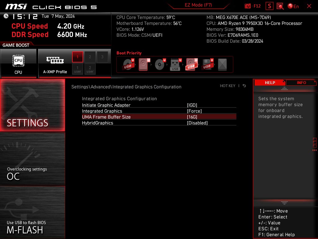

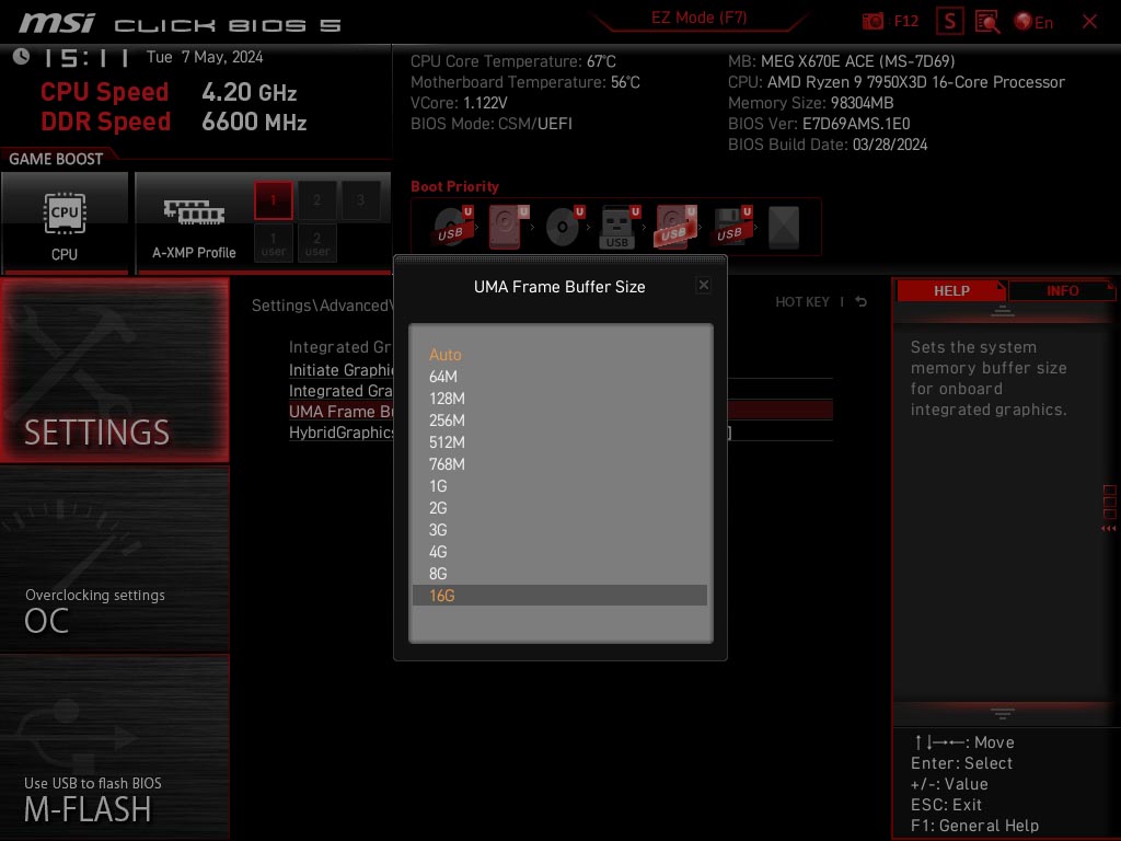

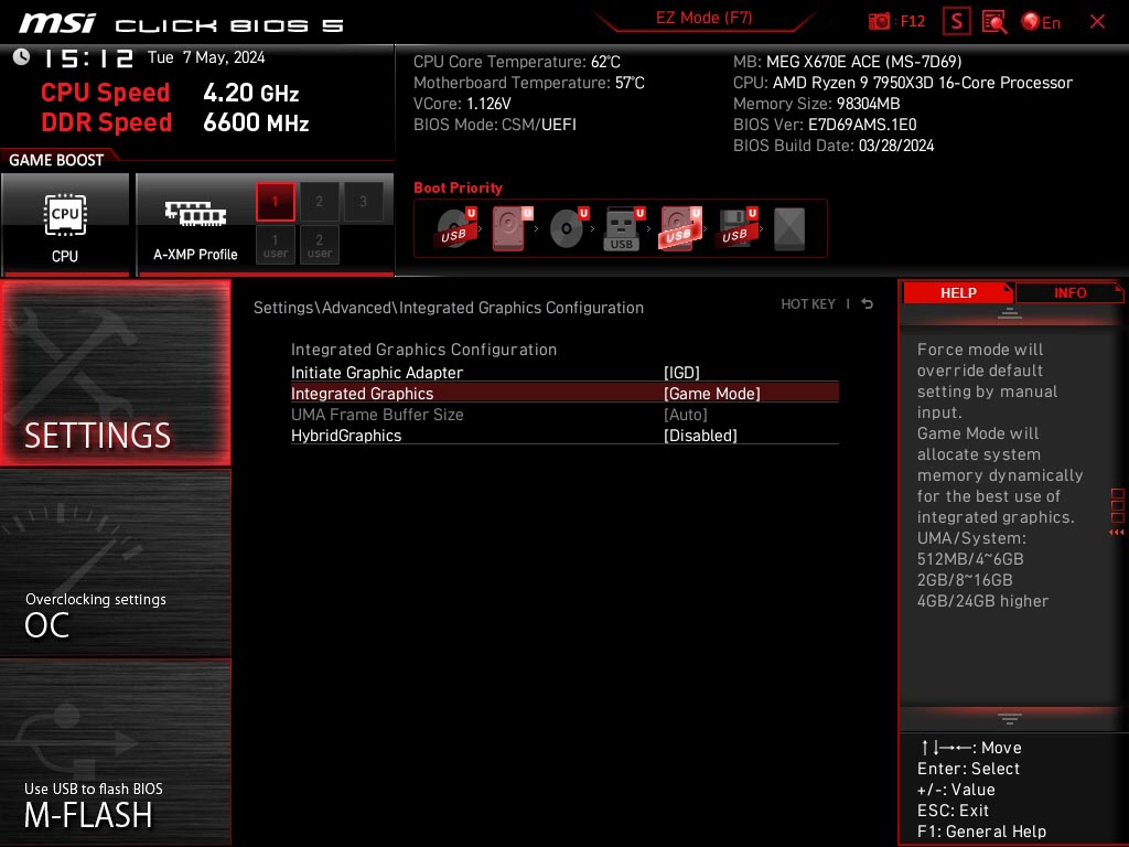

Have you actually looked if you can define any amount, or does UEFi give you some options (e.g 6-8) in different sizes?
Since usually, there are predefined options and one just can't allocate all available RAM to iGPU.
ok, I did check, with Games Mode, you cant set the amount, where UMA Frame Buffer Size is ghosted:
http://www.directemails.info/tom/graphics_card/UEFI_Game_Mode_no_options.jpg
if you press + repeatedly, each is ghosted till you reach Force,
http://www.directemails.info/tom/graphics_card/UEFI_force.jpg
then if I click the UMA Frame Buffer Size I get this menu:
http://www.directemails.info/tom/graphics_card/UEFI_force_options.jpg
and then after selecting 16G I get this:
http://www.directemails.info/tom/graphics_card/UEFI_force_16G.jpg

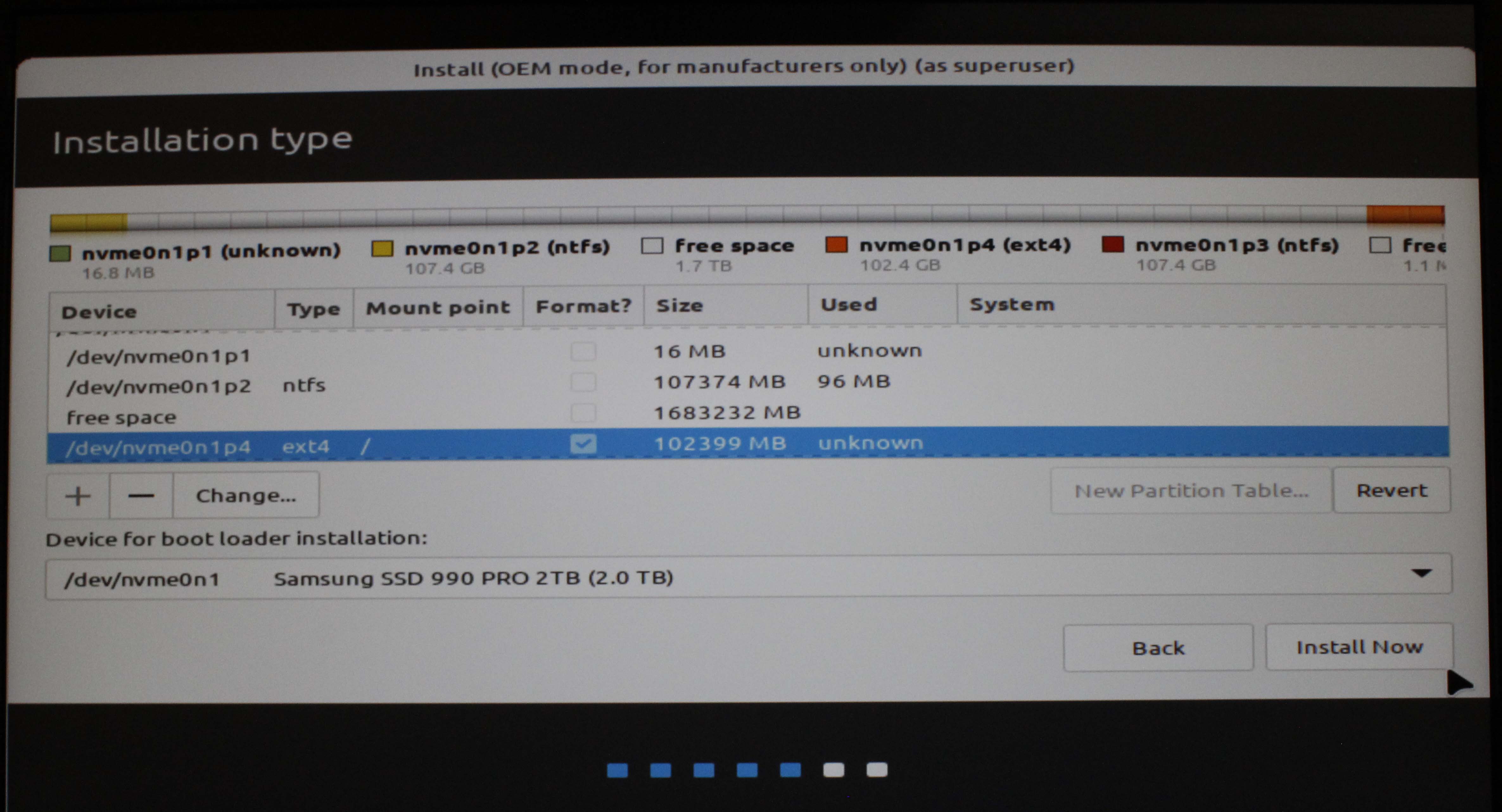

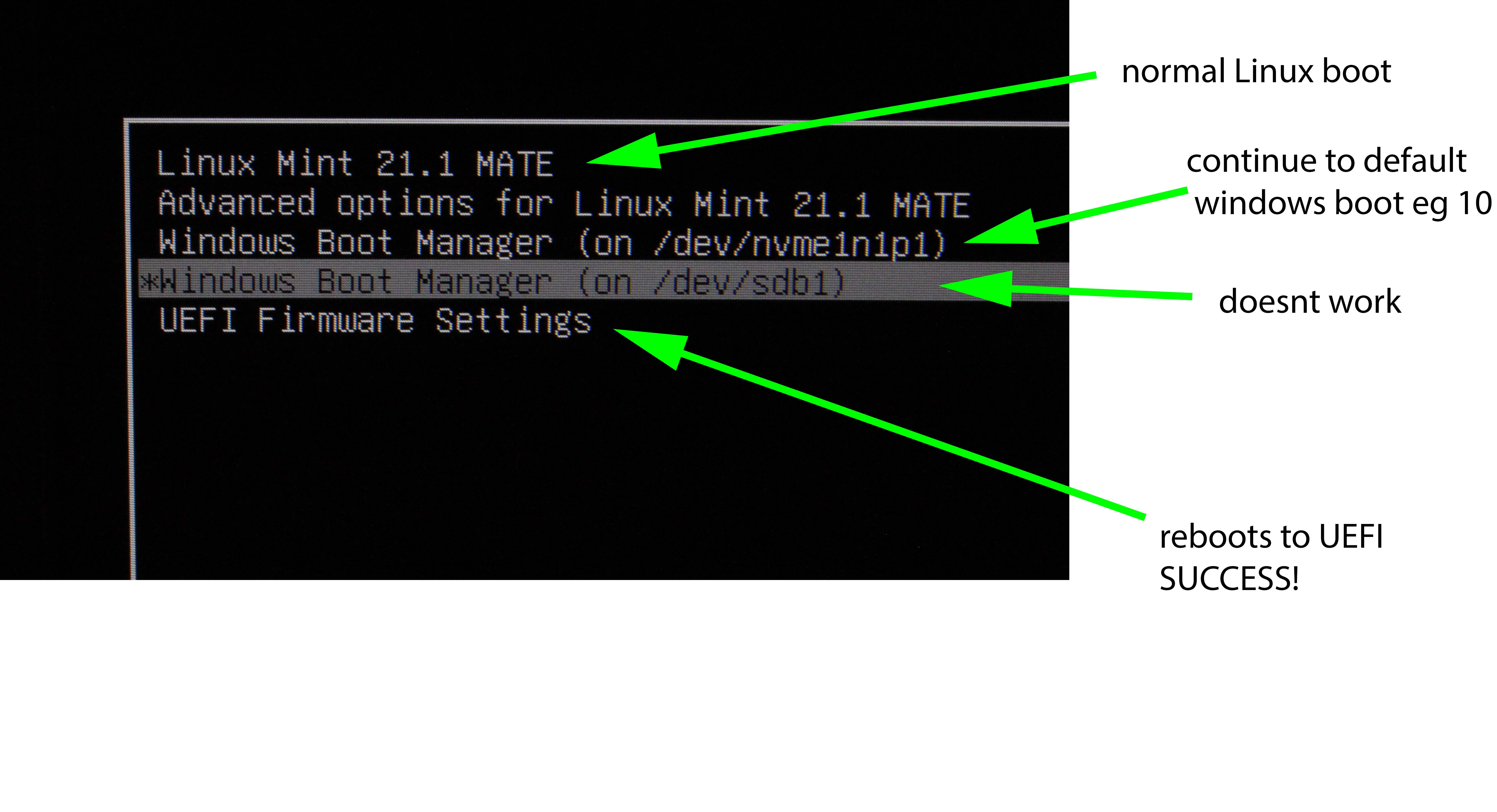

then I installed a 2nd Linux Mint 21.1 to the same M.2, taking photos of each step, including steps which didnt work, where I get an error message. some steps dont allow one to return to the previous page, so I have to photo it even if its wrong. where I photo the error message.
I had to load GParted to comprehend the existing partitions, as the installers view of these is unintelligible, where it gives a different partition count from Windows for the same drive. I carefully made notes of what was where, and verified with sizes allocated when installing the various OSes, also GParted gives different numbers from the installer.
one puzzling thing is I have to say where the boot loader should be, where the default was on another M.2 disk, instead I changed that to this M.2 disk, rather than a partition on this disk, where I am kind of guessing. The risk is that Windows stops booting, but I had backed up the entire drive so can re-establish the earlier arrangement.
this time I used the normal Linux installation, and not the OEM one of last time.
once everything was complete, the machine ejects the install disk and shuts down.
I rebooted and it did go to a Linux boot screen, but no UEFI options. Now I dont know if this is because its a 2nd install, or if because the boot loader was to the wrong place, or if because it isnt the OEM install.
I have tested out the different options, it has an option for both Linux installs, advanced options for each, but these dont lead to the UEFI, but just load the 2 installs of LInux, and it has a windows option, eg I booted to do this message via the windows option of the Linux bootloader.
the windows options of different versions of Windows have all got the partition numbers changed, so it re-establishes those each time, and doesnt just use a fixed version, which is good.
I allocated just 50GB to this 2nd Linux install, as it is just an experiment, and I am keeping a bit of unused diskspace left for any further experiments.

looking at the photos for the OEM install of Linux, I find something unusual:
when I first did the install, there was no UEFI option in the boot screen:
http://www.directemails.info/tom/mobo/linux_boot_options.jpg
but later on in time, there is an UEFI option!
http://www.directemails.info/tom/graphics_card/how_to_get_UEFI.jpg
all I can think is that the later 2nd Windows 10 install must have caused the Linux boot screen to have an extra option!
so I may instead install a 3rd Windows 10 or 11, and see if that causes this.
this does show the value of photographing each step, as there is no way I would remember this!

the 4060 has an unchangeable onboard 8GB?
Yes.
but the 16GB mentioned earlier, is that entirely for the iGPU?
16 GB is usual amount of total system memory, most PCs nowadays have. With 16 GB RAM total, at most i'd allocate 2GB of RAM for iGPU.
This much is actually said in your BIOS as well, whereby:
* total RAM: 4GB to 6GB - 512MB for iGPU.
* total RAM: 8GB to 16GB - 2GB for iGPU.
* total RAM: above 24GB - 4GB for iGPU.
Since you have 96GB of total RAM, not much point to allocate more than 4GB for iGPU. 4GB is still a lot for iGPU VRAM especially since it won't be used for heavy graphical workloads, where it would need that much VRAM.
In your case, i'd allocate 2 GB for iGPU. Or you can leave it into "Game mode", whereby system automatically allocates as much VRAM to iGPU as it needs, depending on a task.

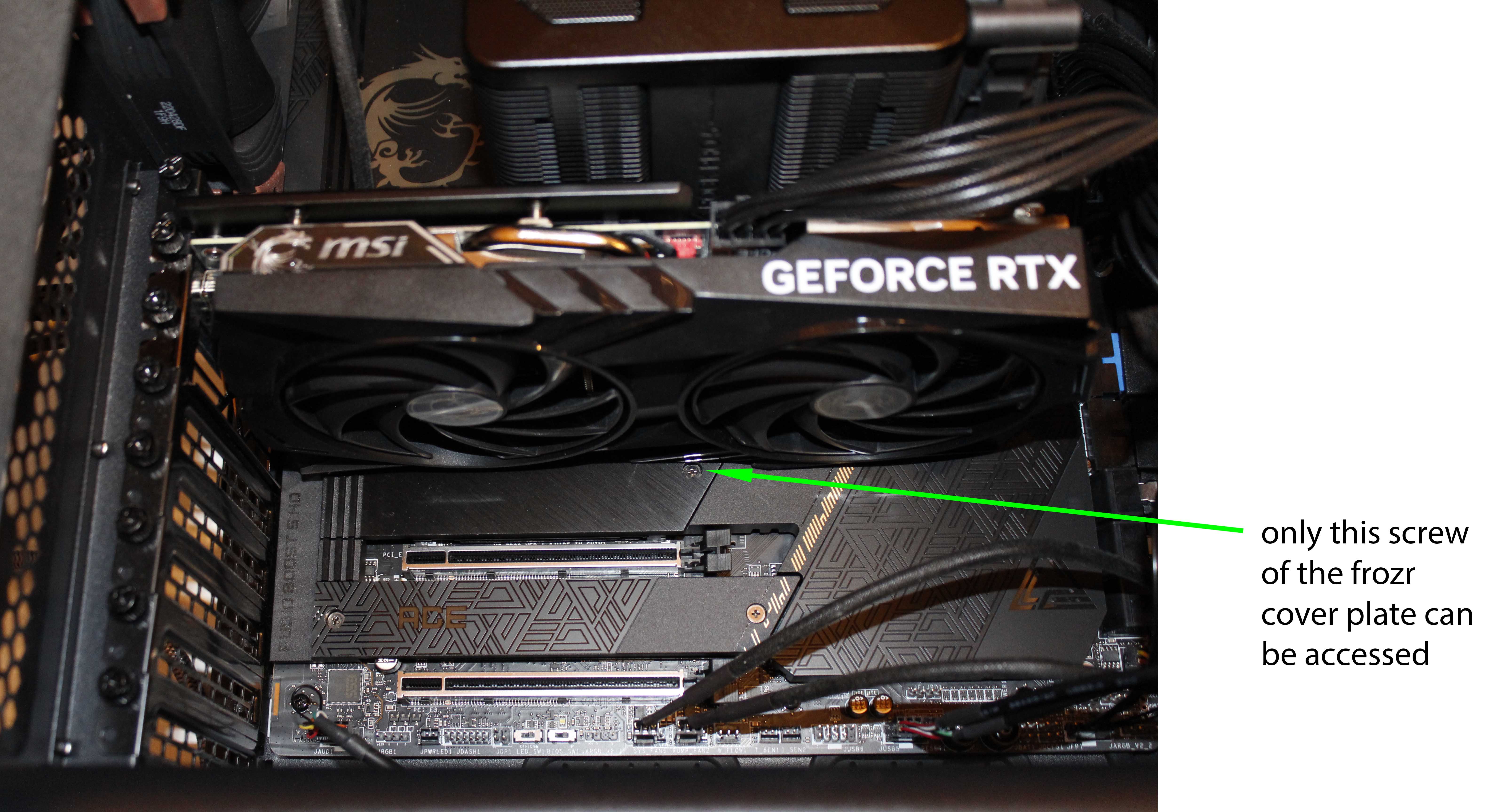

what I would say then with this specific mobo, is that you need to install the graphics card first before the cooler, that way you can access the latch properly.
(Many open loops also include GPU in the loop. In this image, there is dual-GPU in the system, where both GPUs are also included into same loop.)
this would then explain the plumbing I can see in the graphics card. but maybe they should do 2 versions of the graphics card, the one with the plumbing for people who intend to use liquid cooling, and one without the plumbing for people who wont use that. then the graphics card for the latter group can be made much smaller.
Yes.
a 32 bit PC cannot go beyond 4GB, as 2^32 = 4 gigabytes, thus with 32 bit windows, no point in having more than 4GB. I think I got 8GB, which was just in case I installed 64 bit.
I think there is a similar problem with IDE that it has an upper limit.
now this means the market has been held back at 4GB for the 32 bit era, some people would buy 8GB not realising it couldnt be used! I bought it just in case I ran 64 bit XP. also I was programming the hardware directly in 64 bit, where my programs could go beyond 4GB.
but now with 64 bit, you really want to have at least 8GB, so 16GB is then the next step.
but the problem is 16GB and even 32GB are the first steps of a new era, so as the years go by at some point this will be too little. you can do everything you would normally want with say 8GB. but the problem is the firms out there artificially force you to use more than is needed.
remember that a 2 hour film on a DVD is less than 5GB, so 5GB is a ton of storage.
that sounds a better MO, to allocate whatever is needed. good design is about avoiding fixed limits as much as possible, where people have invented MOs for doing this.

progress report: I have been experimenting with installing Linux and Windows scratch installs to a 2nd drive, to see how they co-exist with the installs on the first drive. this is so in the future if an install becomes broken where I dont want to reformat in case I need to salvage stuff, that I dont find myself painted into a corner variously, better to test what can and cannot be done now before I put too much time and installations on permanent installs. eg I might have a win10 + win11 on disk 1, then win10 becomes broken, and install win10 to disk2 and then find win11 on disk 1 is lost.
I decided to see what happens if I put partitions at the start and end of the 2nd 2T M.2 drive, both of 100G called Dummy1 and Dummy2. Because when I installed win10 to the first disk, the installation put some extra partitions, so I want to see what happens if I obstruct that. does it work around them or does the install fail.
I then installed Linux Mint in order to also see what happens with Windows installs if you install Linux first.
I selected for the boot loader to be that same 2nd disk
where in the photo, that 2nd disk is /dev/nvme0n1 where the highlighted item is where the install will go.
Linux Mint did install, but the mobo's loader options are only the first M.2 drive, either the Windows loader or the ubuntu loader on the other drive. there arent 2 ubuntu loader options.
but I get all 3 linux installs from the ubuntu loader, 2 on the first disk, 2 on the 2nd disk.

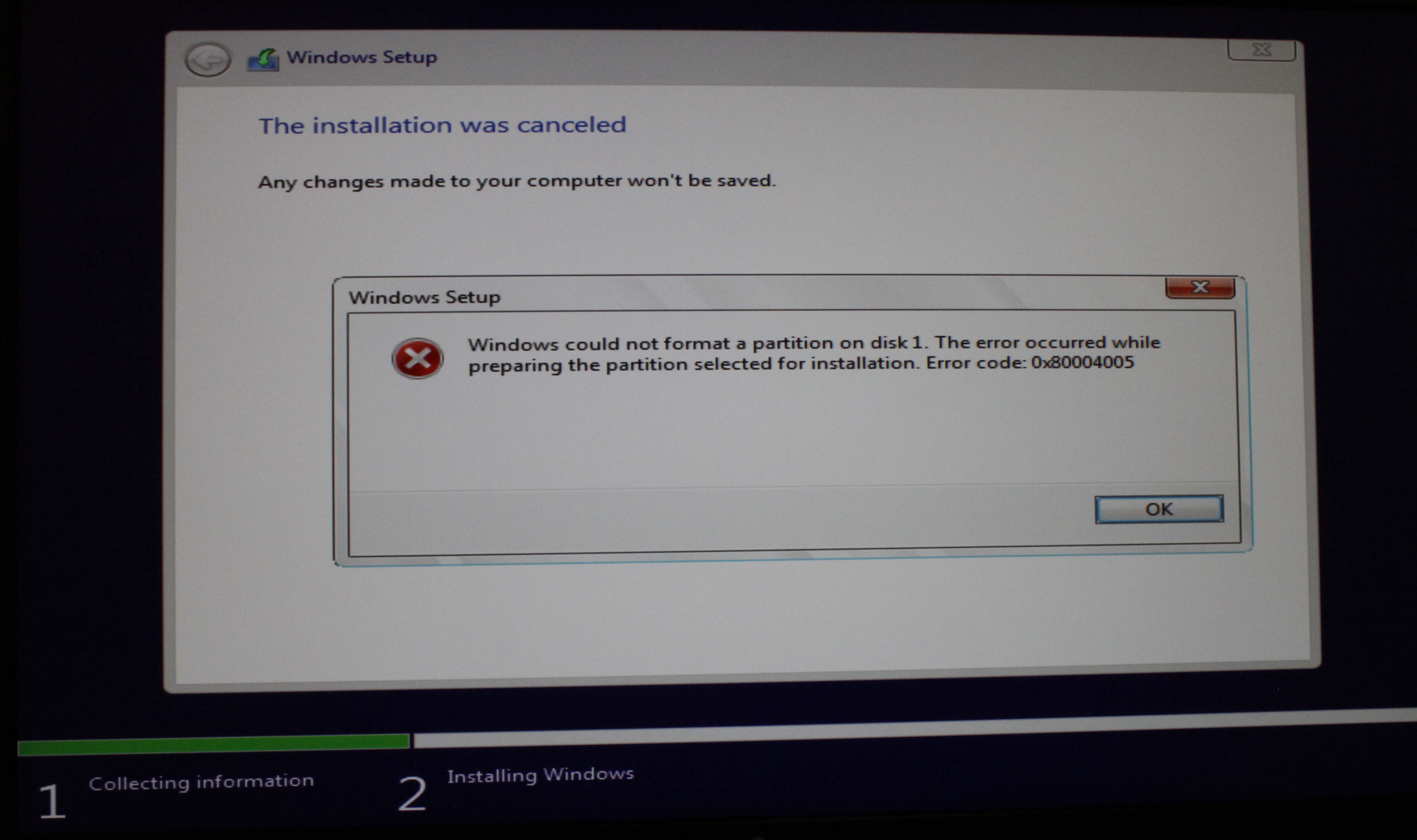

I then decided to see what happens if I hem in the Windows 10 install by arranging partitions thus:
Dummy1 ; Ballast1 ; for_windows11 ; Ballast2 ; for_windows10 ; Ballast3 ; Linux_Mint ; Dummy2
where there is no unallocated space.

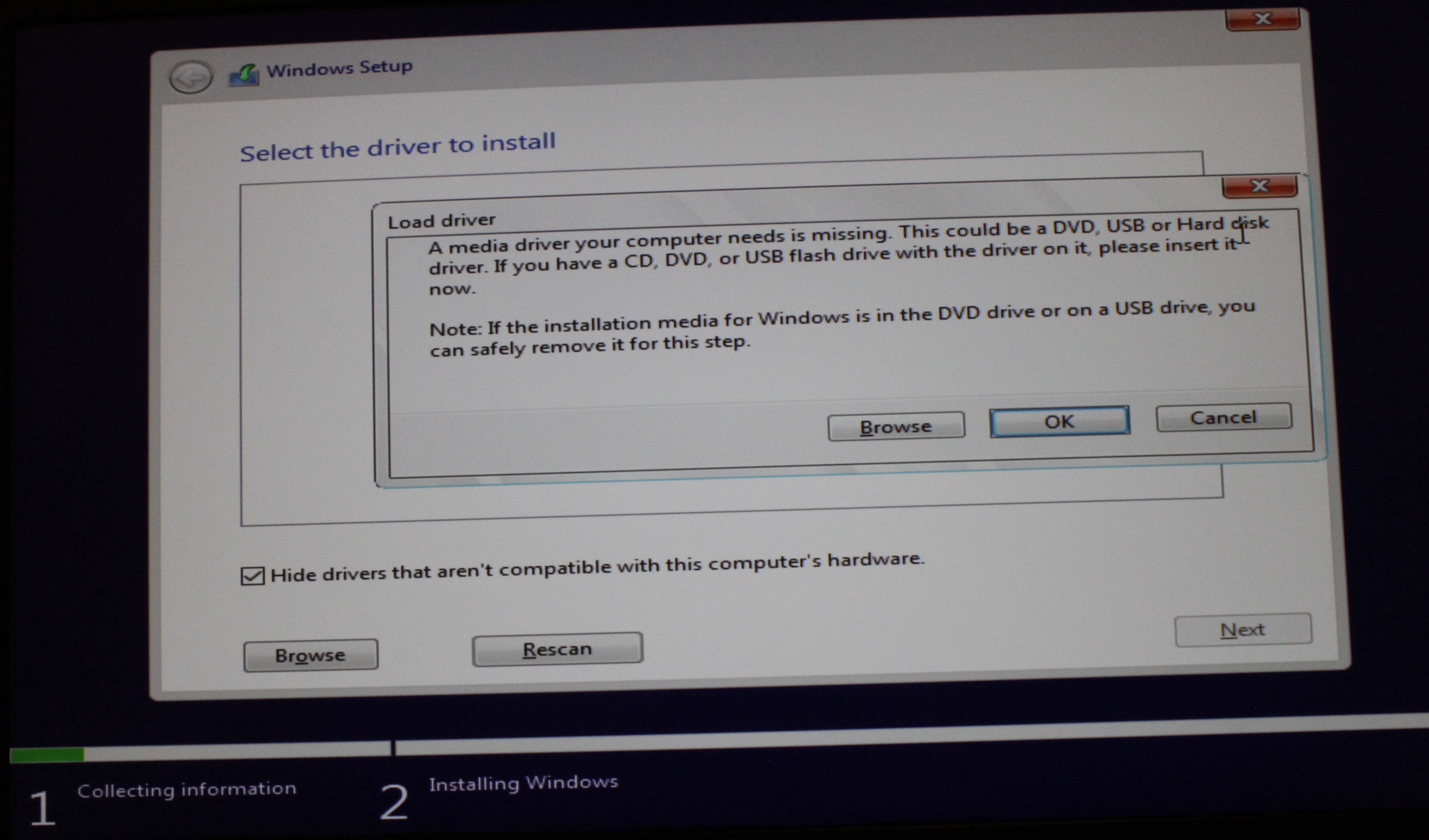

with this, the Windows install gives me an error message:
A media driver your computer needs is missing ....
rebooted in case it was a read write error of the optical drive, but same message.
so now I deleted the for_windows10 partition via another Windows desktop, and this time didnt get that error message. so one shouldnt set aside a partition for a Windows 10 install, but should set aside unallocated space.
I selected the unallocated space which used to be for_windows10 to install Windows 10, and got an error message with error number 0x80004005
I then tried various things, eg subdividing the zone with some 100G before and after the allocation zone, but same error. then tried also deleting Dummy1, in case it wants space at the start of the disk, but same error.
so it looks like to get Windows 10 64 bit installed on a disk, the first thing done with that disk needs to be either a Windows 10 or 11 install, if you create other partitions first, this will be problematic.

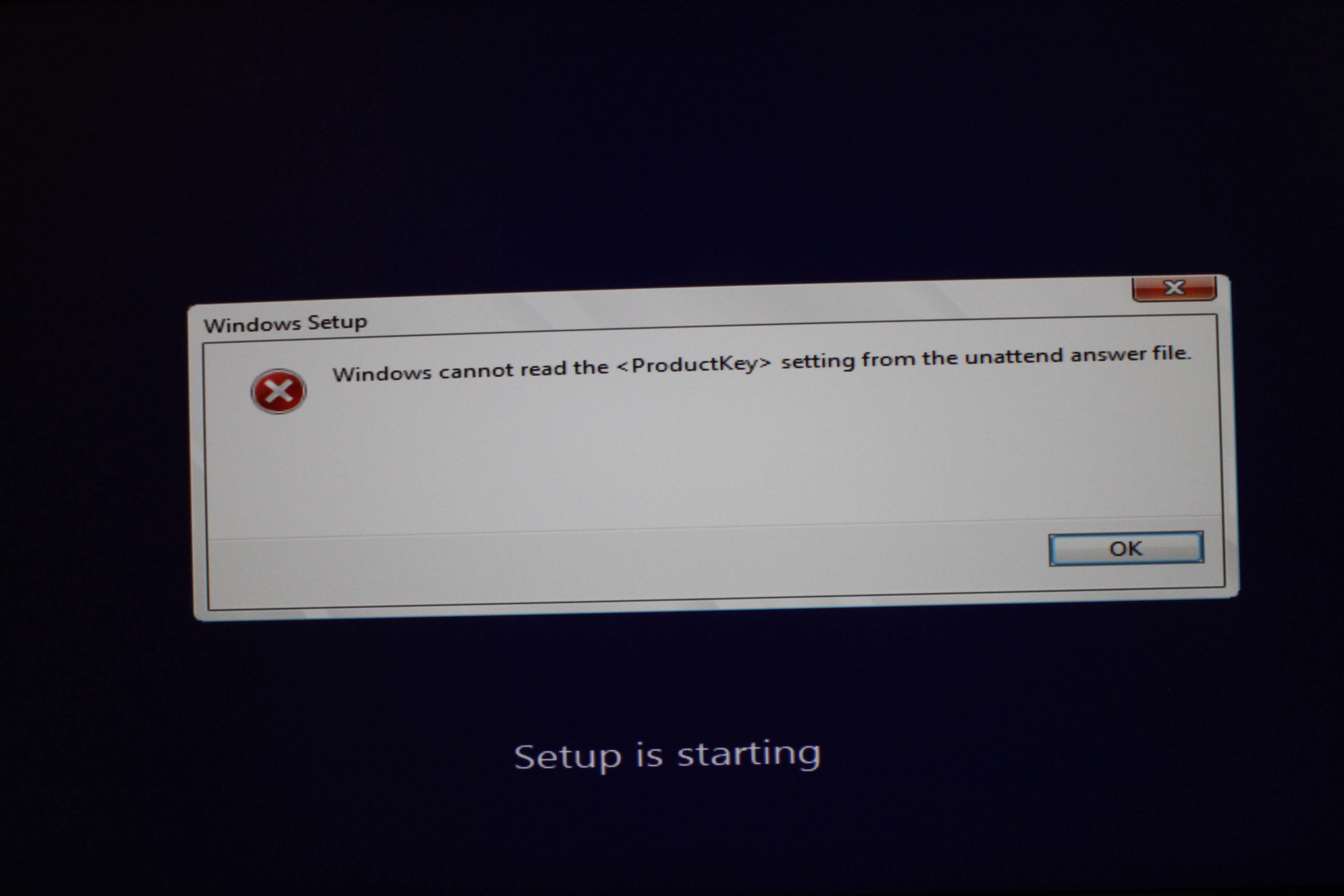

windows 10 install error message:
http://www.directemails.info/tom/win10/unattend_win10.jpg
windows 11 install error message:
http://www.directemails.info/tom/win10/unattend_win11.jpg
I want to do a manual install, so I dont want to arrange some unattend answer file.
Only remaining thing I can think of is to remove the first disk with all the existing OSes, then maybe they will install. I got through that error message when I had the Linux install on that disk, but then ran into a different error message later.
unless I temporarily install Linux to get past that, then from the win 10 install delete the Linux install and then continue the win 10 install.
the people who put each OS on a different disk, I dont know if they run into this problem when they install the 2nd version of windows on the 2nd disk. eg say they install win10 on disk 1, do they run into this error message when they try to install win11 on disk 2?
is the problem because I have several installs of both windows 10 and windows 11 on the first disk?
eg would say win10 on disk 1 and win11 on disk 2 work, but not win 10 on disk 1 and then win 10 on disk 2?
where different license keys for those two win 10's, I have 8 license keys currently.
I have a photo here also of how with the frozr cover plate of M2_2 and M2_3, only one screw is accessible, the other is eclipsed by the 4060 graphics card:
http://www.directemails.info/tom/win10/frozr_eclipsed.jpg
USAFRet
Probably.
It is very easy to get things in a totally screwed up state.
I strongly suggest starting over.
One single drive, one OS.
During the install, delete ALL existing partitions.
Get it up and running.
Use it for a few days.
Then and only then, branch out.
