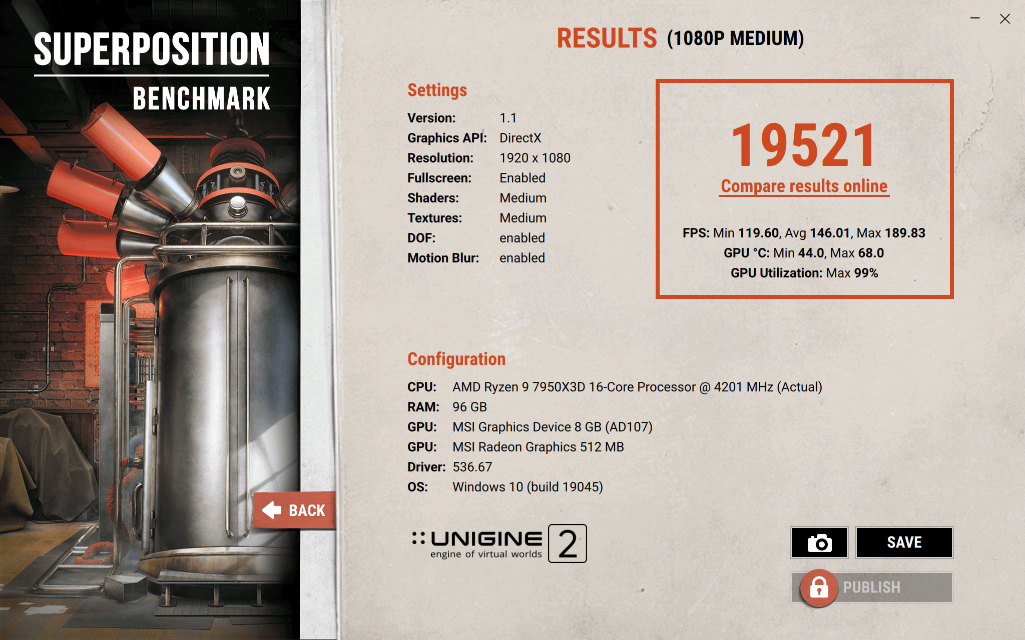

first, I did the graphics benchmarks with unigine and the results are embarrassing:
the mobo USB C to DP outdid the RTX 4060 DP to DP on EVERY test, namely 1080 and 4K, I havent done 8K yet as I thought 4K was the top speed, but now looking at the box it does say it does 8K @ 60Hz.
when I changed cable to USB C from the mobo back panel, there was no audio, I had to change the audio to an identical setting then I got audio, so I did the mobo test with both no sound and sound just in case lack of sounds sped things up.
now the only explanation I can give is that the mobo routes the graphics to the USB C socket,
but even then it is embarrassing, that this is FASTER than the RTX 4060's inbuilt DP ports!
here are the screenshots if you want to decipher them, as its currently over my head:
RTX 4060 1080 test:
http://www.directemails.info/tom/graphics_card/benchmark_RTX4060_1080.jpg
18826
then mobo CPU without audio 1080 test:
http://www.directemails.info/tom/graphics_card/benchmark_cpu_1080.jpg
19523, which is 3.7% faster
then mobo CPU with audio 1080 test:
http://www.directemails.info/tom/graphics_card/benchmark_mobo_1080_with_sound.jpg
19521, approx the same,
where I did all the RTX 4060 tests first, then all the mobo ones and have left it connected to the mobo now as this is faster,

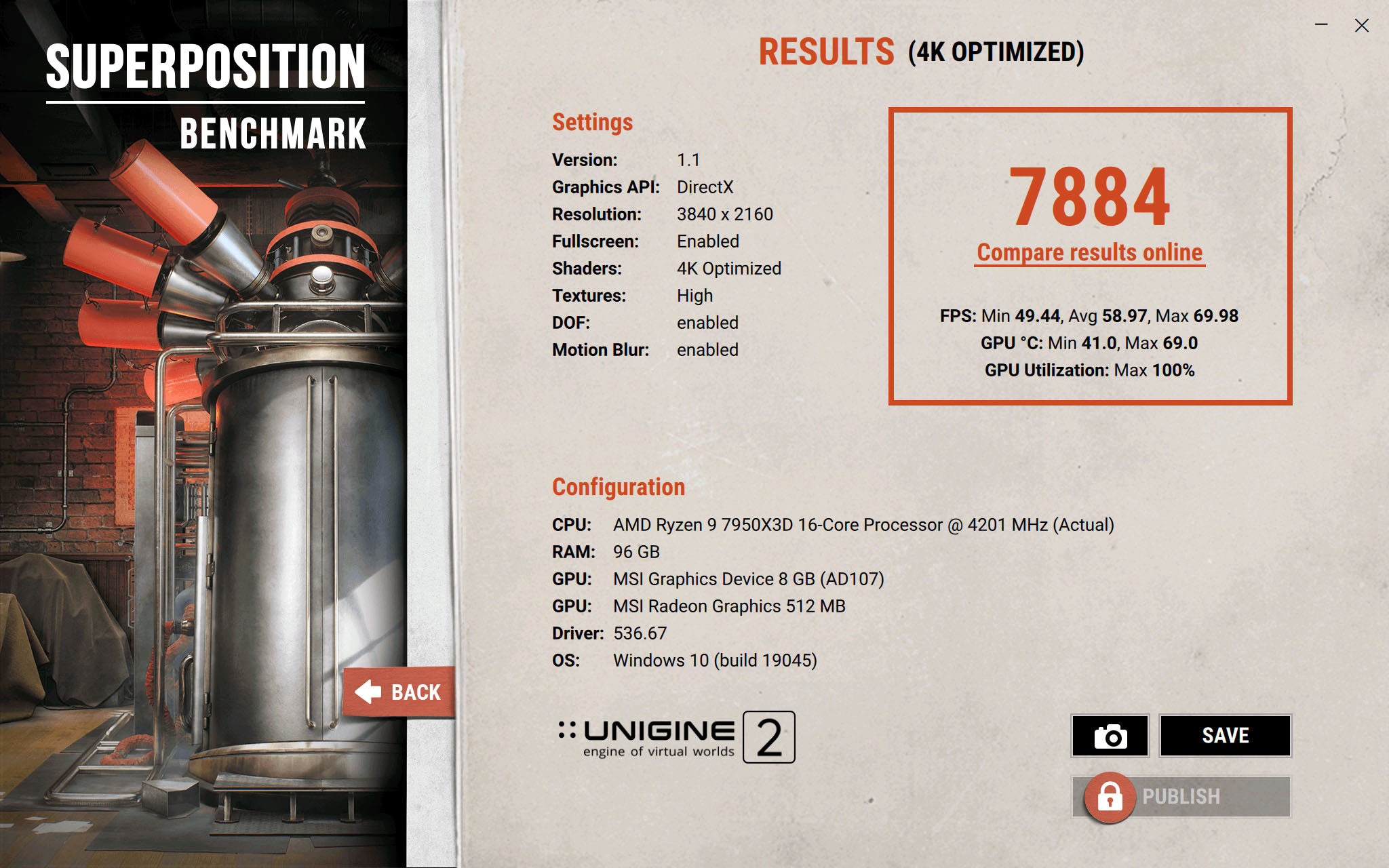

here are the 4K tests:
RTX 4060 4K test:
http://www.directemails.info/tom/graphics_card/benchmark_RTX4060_4K.jpg
7807,
then the mobo 4K without audio:
http://www.directemails.info/tom/graphics_card/benchmark_mobo_4K.jpg
7878, 0.9% faster,
then the mobo 4K with audio:
http://www.directemails.info/tom/graphics_card/benchmark_mobo_4K_with_sound.jpg
7884, which is in fact slightly faster.

Based on the screenshots, it looks like when you have RTX 4060 installed inside the PC and you use MoBo display port, the benchmark actually uses both GPUs; iGPU and dGPU at once, to complete the task. That's why you see performance uplift when display is connected to the MoBo.
Laptops usually do it, utilizing both the iGPU (inside the CPU) and dGPU (dedicated GPU). But desktop PCs are also capable of doing that.
To validate it once and for all:
* Remove RTX 4060 from the PC, completely
* Have monitor hooked to MoBo and run the presets again
This way, there is no way, that PC can use RTX 4060 alongside Radeon graphics when you benchmark your iGPU.
There is a way to disable iGPU from UEFI when you have dGPU installed but it is difficult to do. Better to remove RTX 4060 completely from the system, easier this way (you doesn't have to dabble in UEFI and there is always a possibility that disabling from UEFI doesn't actually work).
I also see that you do not have latest GPU drivers. Benchmark shows your GPU driver version to be 536.67 while the latest is 552.22
Link: https://www.nvidia.com/download/driverResults.aspx/224154/en-us/

eg Aeacus said the USB C mobo port will just be CPU graphics, but in fact is faster than the 4060's DP port.
either that, or the benchmarking software is benchmarking the wrong thing. but the benchmarking software is also his advice.

Regarding Unigine Superposition; you asked a program to measure GPU performance. Unigine Superposition is the best GPU benchmark program there is. But there are others as well, like 3DMark, PassMark, Cinebench.

By default, iGPU should be disabled when dGPU is installed. This is so with most desktop PCs and for Intel. Now, i don't know if you enabled iGPU from UEFI once you installed your dGPU or not. Or perhaps it is automatically enabled when you plug monitor to MoBo, despite having dGPU. But PC can use both GPUs at the same time. Many laptops do it already.
This may not be user choice. The setting is in BIOS/UEFI but what is default is anybody's guess.
In my case both the iGPU and dGPU are enabled. I could and probably should disable the iGPU because the dGPU does all the work all the time anyway, and the iGPU does nothing except hog up to 32Gb of RAM.
But nothing is broken and i do not relish a trip to BIOS that may or may not screw something up, so i'll leave it be for now.
Anywa, unless the iGPU is specifically disabled in BIOS, it will be available and it's up to the OS to do something with it. Like give it RAM it doesn't need. *sigh*
you need to clarify what iGPU an dGPU are, and also maybe some screenshots of say an MSI UEFI setup where the iGPU would be disabled, or other screenshots if not from the UEFI.
you probably explained about iGPU but it would be work to locate that, it might be in the earlier topic!
