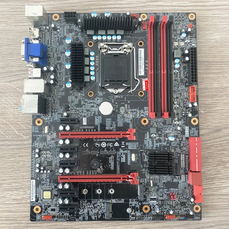

So the PSU is 7 years old. I'd look into a replacement unit. Looking at the motherboard;
does not seem to have any proprietary connectors. So you're free to choose any aftermarket PSU.
