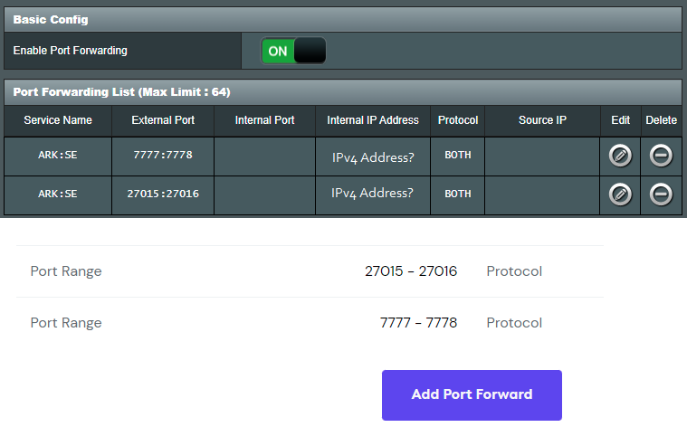

This is my port forwarding configuration for my router (top) and my dad's modem(?) below, I've tried adjusting the ranges, or writing them differently to see if I made an error somewhere, but I'm not really tech savvy enough to spot my own mistakes. Usually trial and error works for me with port forwarding, but this time that method is not resolving the issue.
What is the WAN address on the AX86U ? If it is not your public IP address then port forwarding won't work. My GUESS is that there are port forwarding rules setup on the Xfinity router but that the WAN address on your Asus doesn't match the rules. There may have been an IP reservation made for the old router or you might have had a static IP on the WAN of the old router.
I believe you're correct, the WAN and public IP addresses are different. Is there something I can do to remedy that?
You will have to investigate the configuration on the Xfinity router.

I'm not sure about the access point. The Xfinity Gateway is a bit more frustrating than the Asus, but the WAN for Xfinity Gateway does match the public IP. Problem for me is the port forwarding for Xfinity doesn't give me an option to input an IP address? I have to select from devices there, and my desktop is downstairs running off the Asus Wifi network, so it doesn't show up there as an option. Not really sure how to get the two systems to communicate and work together, if I need to configure the Gateway to work with my router.
You configure your Asus as an access point and then your PC does show up as a device off the Xfinity.
It is easy with Asus. You toggle the mode to access point. Boom you are done.
Good news is my desktop and phone showed up under the devices in the Xfinity Gateway after switching to access point! I port forwarded off of the Xfinity Gateway and put up the server just to test, and my friend was able to find it and connect, however now I can't find/connect to it on my own device. I remember there being some sort of issue with putting up a server and playing on the same machine, but I was able to do it with my old set-up so I know it's possible. Any thoughts on that?
